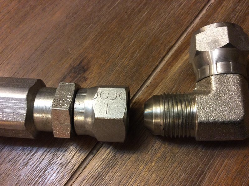

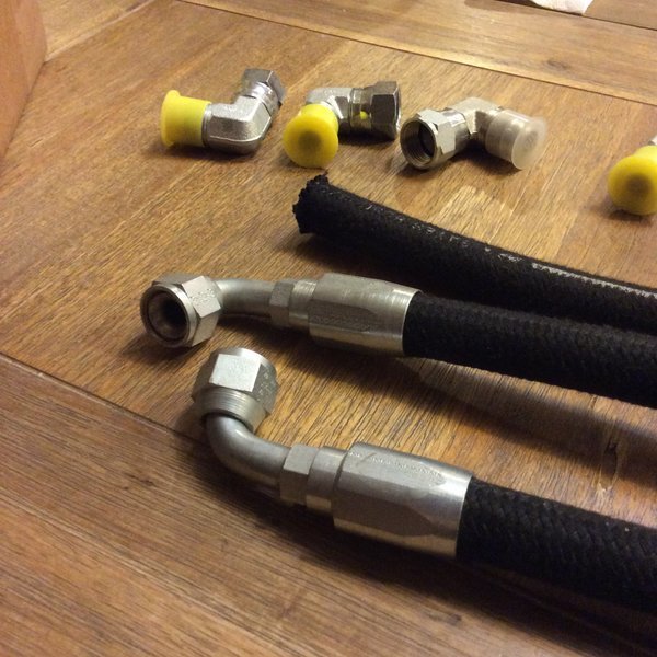

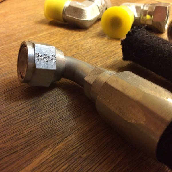

    If you could get me the number for the 90 in the last pic that would be great

    37 degree JIC fitting number 8. You can also take your hose down to Napa and they can make new hoses for you. Cheaper if you do it yourself.

    That looks like an icon fitting

    FYI you're looking for a -8 ORB (O Ring Boss) to 8 JIC 90, it's not specific to any single shock manufacturer.
    Any hydraulic supply shop worth a shit will have those in stock. I might even have some in my garage from changing a FJ guy's Resi's around a couple months ago.

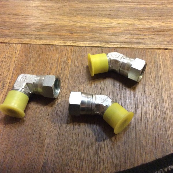

    The new resi setup I did. ORB 90 off the shock and a ORB 45 at the resi. Built a new hose at work and good to go.
