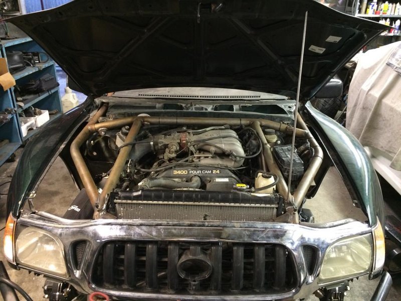

    I love this style of engine cage. You can squeeze 10" shocks in there and keep building on to it in stages.tapatalk_1448925577686.jpg

    We all know bumping off that uca means chopping up a good chunk of core support.

    This is the style that I have on my truck, just make sure with any engine cage you have plenty of vertical tubes from the frame up to the shock mount/bump stop area.
