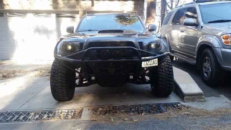

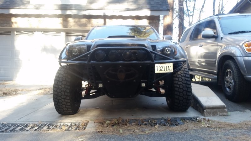

    Alright so I'm curious what spring rate everyone is running on your 8 inch coilovers? The coilovers that I bought used came off of a first gen, and I'm pretty sure the springs on them are too light. When I first put the coilovers on and had them set with little-to-no preload just enough to hold the spring. The truck Road great but it sat extremely low. So I had to crank them up to get the normal ride height. And now they ride too stiff. I'm 4wd so preferably people without lift spindles chime in please.
    How it sat at first. My concern with the ride height this low is dragging every damn rock in the desert with my skid plate
    How it's sitting now.

    You
    You should be running 3.0x16x600lb coils

    Looks like it's running at right height so you should have 600 or 650 if you have some weight

    600lbs is the correct spring rate for lt second gens with moderate to no extra weight on the front end
