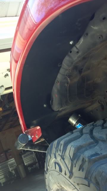

    atvlifestyle
    atvlifestyle Well-Known Member
    Nov 3, 2010
    #45647
    1,735
    Michigan
    01 trd tacoma
    supercharged with MCM front kit
    I have ABS ones. Just tabs welded on the inside and the outside sits on the lip of the fiberglass.
  11. Jan 4, 2017 at 5:24 PM
    Tacomoto23
    Tacomoto23 Well-Known Member
    Aug 31, 2014
    #137329
    1,316
    Carey
    Torrance,CA
    21’ TRD 4x4
    Nice, that's super clean. Any problems with the Abs liner not being secured directly to the fiberglass lip?
  12. Jan 4, 2017 at 5:28 PM
    atvlifestyle
    Nov 3, 2010
    #45647
    1,735
    Michigan
    01 trd tacoma
    No. been in there 5 years or so.

  13. Jan 4, 2017 at 5:29 PM
    Tacomoto23
    Aug 31, 2014
    #137329
    1,316
    Carey
    Torrance,CA
    21’ TRD 4x4
    As far as getting that ABS plastic, do you think a standard hardware store like lowes or Homedepot might have something like that?
  14. Jan 4, 2017 at 5:33 PM
    atvlifestyle
    Nov 3, 2010
    #45647
    1,735
    Michigan
    01 trd tacoma
    I'm not sure what you can get from the hardware store but mine came from Grainger. I think it's 1/8th sheet but don't remember for sure anymore.
