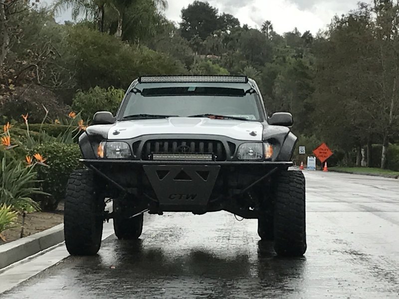

    Heres mine with the new kit on it finally. Took it home last Friday enjoying it now. Daily driver,just have minor things to do then test.

    Looks awesome.

    :drool: Looks amazing:thumbsup:

    If I could like this twice I would!
