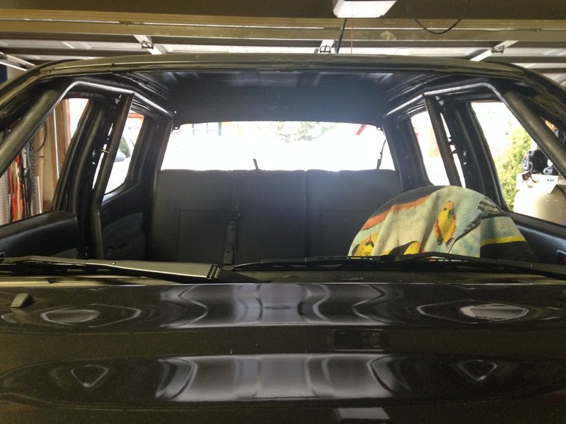

    Naw, I bought mine new. Got all the pillars done, back seat still fits, and the 3 main roof tubes bent up. We'll see how long notching takesimage.jpgimage.jpg
