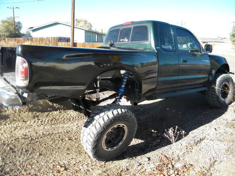

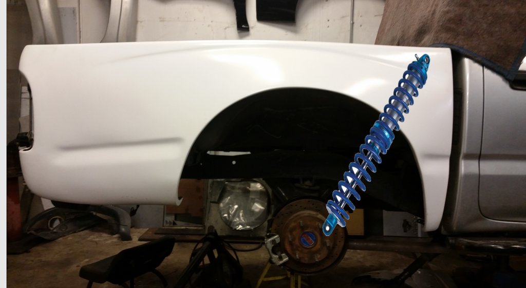

    18" Kings. Guessing they'll be tucked in like this guys setup: "I run 16" king coilovers and get about 19" of usable travel out of the rear."
    But with the link setup like this rig.
    http://www.pirate4x4.com/forum/toyo...rail-gear-front-3-link-finally-available.html

    18's probably a little long for the trailing arms anyways. Running pro 2 style links with the 18's will put them pretty far out of the bed unless you put an extreme angle on them, but should definetly get you your 20". Is still try to get the shop to build you what you asked for, but if you feel like you're getting what your paying for it is your truck and should still be a blast to drive.

    Yea that's gonna be a big coilover in there.
    Cool though. I was just curious. Id rather do trailing arms even with a 3 link personally to run a smaller bed cage and coilover.
    I'm sure it'll be fine though.

    lol I like the crop of the shock into the photo

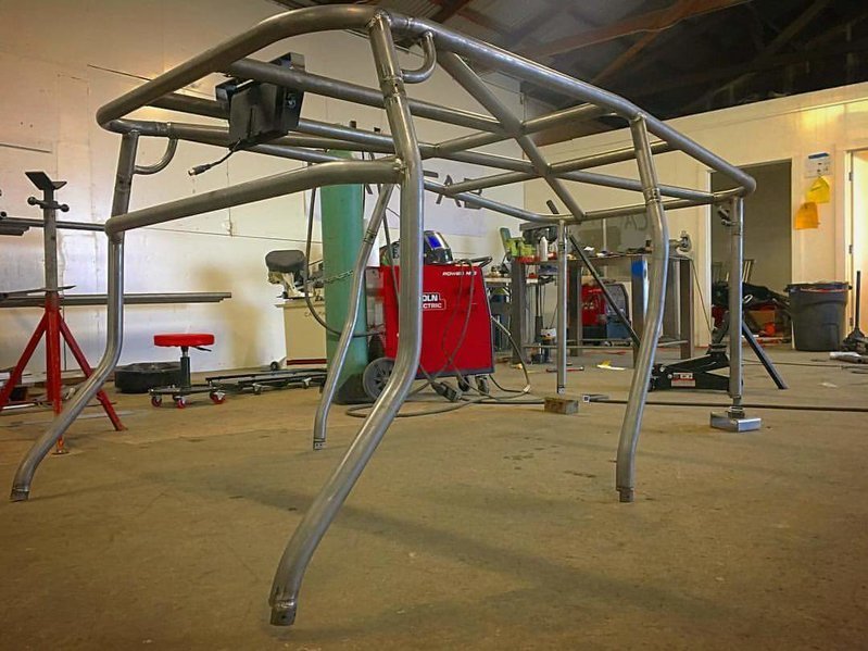

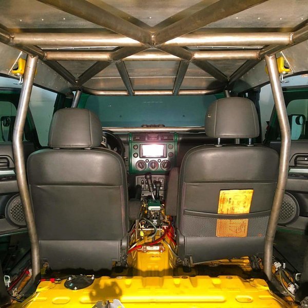

    Critiques for the cage that's attached to the body (does not contact frame at all), in the event of a rollover?

    its got a lot of joints to fail (although i have never seen one of them fail) I cant tell but if its got some good size floor plates i am sure its ok for a slow roll over. i would also like to see the seats attached to the cage, but thats just me

    they are afraid of tube junctions I see. I guess it's better than a hole in the head. barely. I am a fan of the tin work on the roof. looks fancy.

    It's a cage for appearances obviously

    Yup. Stolen off of facebook. @jeffz0rz that was the local guy I almost went with instead of you. Then when he insisted Tacom frames were fully boxed and said he'd never installed an SUA kit I went elsewhere lol. I asked him why it wasnt tied to the frame or if it was welded to the body and he said he used "huge sandwich plates on the body to hold it in place".

    That's how cages are built in unibody cars that go pretty darn fast but landing them on the frame will always be the go-to method.

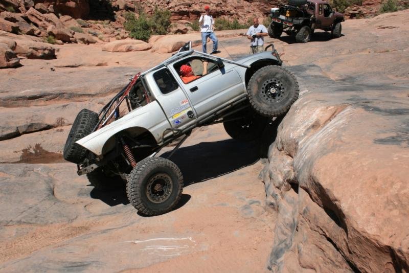

    The on on the left is what that cage went in. Dude builds some mean stuff. They aren't afraid of junctions nor for apperiances just FYI

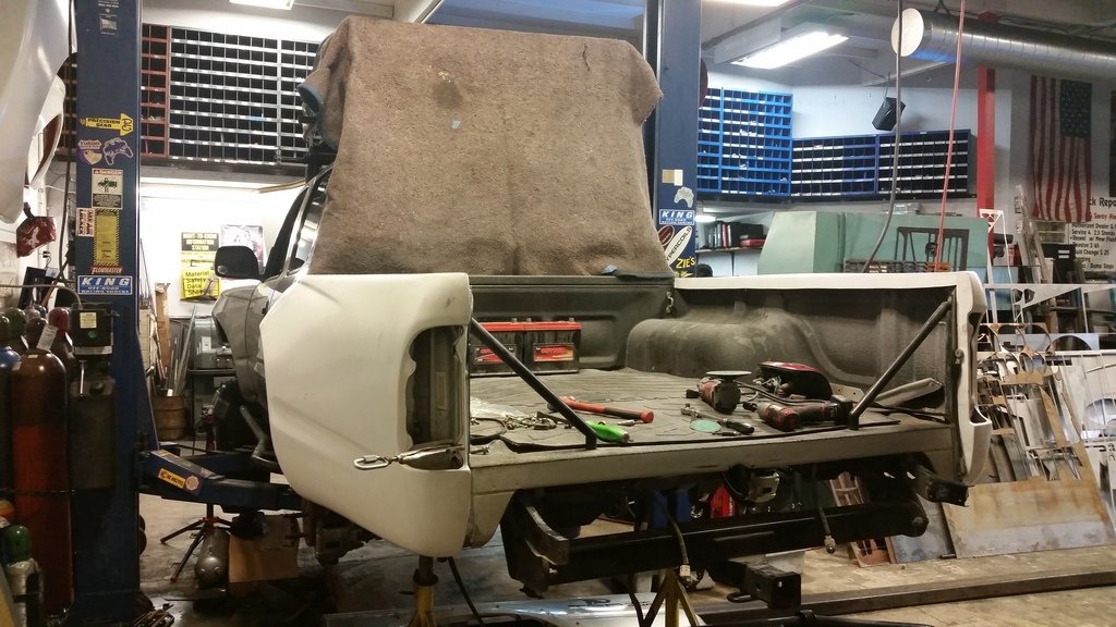

    Anyways.....image.jpg image.jpg image.jpgBeds off, gonna start cutting all the gay shit out and notch the frame
