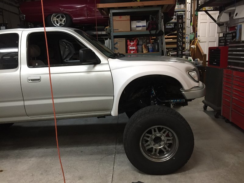

    So I'm thinking of switching the current 300-18-600 king springs for some 300-18-550 eibach springs to get the ride height down a bit more.
    Anyone have any input on this?
    It sits right about .75" above the midway point in the travel right now
    ChadsPride likes this.

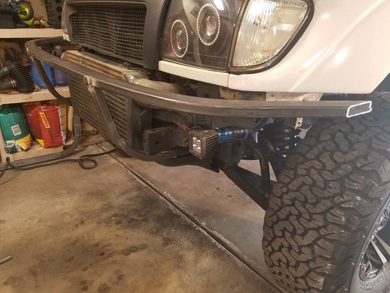

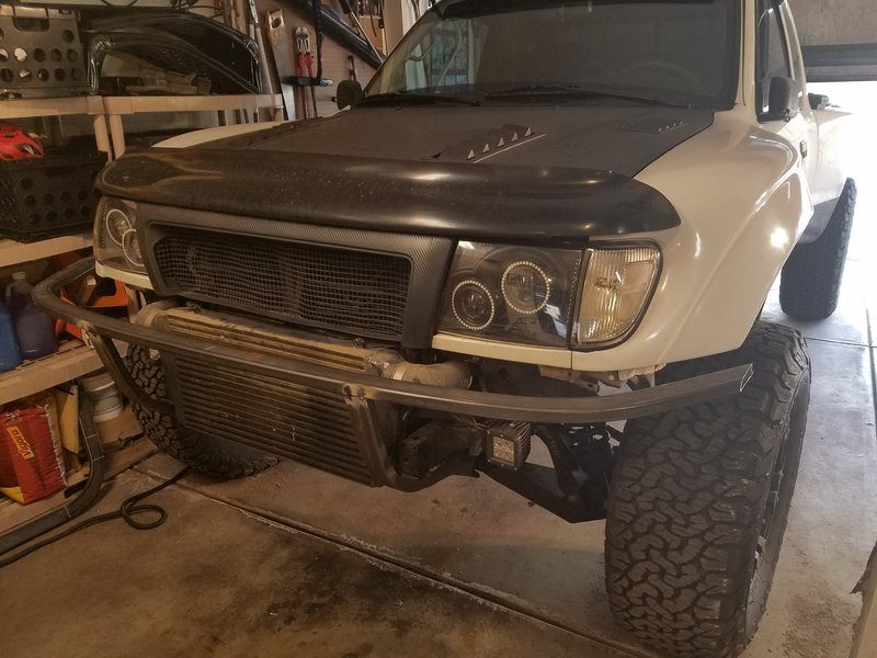

    Very rough start on my front bumper. I'm using 2x1 rectangle that is 3mm thick which is the same size as my bed cage which is round 1.75 dom tube. There will be a lot more bracing. I'm also going to plate a good amount of it for added strength as I know the rectangular tube is not as strong as the round. Seems everyone has round so wanted to do something different. What do you guys think? Am I just wasting my time or do you think with enough plate and bracing I can create a unique, solid, cool bumper?
    Sterling_vH111 and MadTaco461 like this.

    My understanding from your post is that it's about halfway in it's travel point at ride height ?
    Is the rear end stock?

    Should be fine, I think it looks better than round tube anyways
    j0shu4[QUOTED] likes this.

    Thanks man. Lots of grinding......
    :thumbsup:
