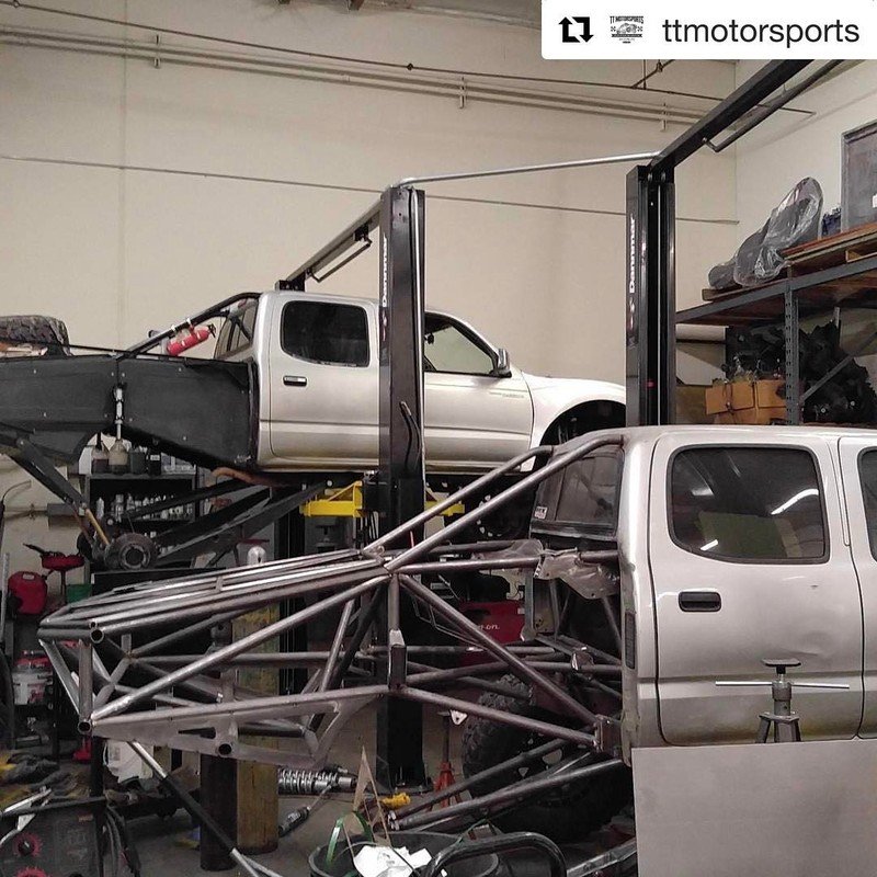

  19. Feb 5, 2017 at 1:37 AM
    doyouquaxu
    doyouquaxu Well-Known Member
    Dec 6, 2014
    #143779
    864
    Tommy seems hopeful the truck should be done in a few weeks. See my build thread for more pics.
    16177737_10210239669841790_1677832694274_fc8337f313fa663ed3fbf93b8e02a9ac775ec2b3.jpg
  20. Feb 5, 2017 at 9:32 AM
    Blackdawg
    Blackdawg Dr. Frankenstein
    Dec 31, 2010
    #48500
    81,631
    Monte
    Wyoming/St. Louis
    The Trifecta of Taco's
    Damn two linked 1st gens. Sick.
