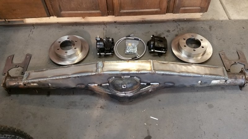

    Should look similar to this......

    How are those rear disc brakes treating you?

    They're doing really good. Between those and the front tundra brakes the 35s and whole truck have no problem stopping. I might need to adjust them a little better though as the rears lock up way before the front but I've heard that's what you want. Only suck part is no e brake.....but I've got a manual line lock I'm going to put in the cab. Like most of us I hate brake lines and all that goes with it. I have to reroute the line into the cab so I can get the ebrake/lock to work. On my to do list, but at the bottom of it for now. Overall I really like them! I would've had to buy all new brakes and drums for the rear so it was just as cost effective to get the discs.

    With the dmz kit, has anyone been able to keep the stock parking break intact? I'm assuming that it will probably be too short?

    What kit is it?
    I'll have to do new brakes on my T100 axle so thinking about this.

    Trail Gear makes the kits and pretty sure they supply everyone else. I've seen an LCE one and All Pro but believen they are Trail Gear. Ran right around $400 shipped to me.....

    No issues here with the parking brake. I think everyone else is talking about when they change the entire diff or switch to disc brakes without an internal parking brake or a caliper with a built in parking brake.

    My question was just random lol. So did you just keep it routed down the driver leaf, similar to how it is stock?

    Yep! I have the stock parking break line intact

    Lol yeah I just routed it down the driver leaf and attached the factory eyelet to one of the bolts on the clips of the leaf springs.
