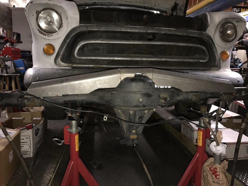

    I had one of those trusses sitting at the shop for my axle. After seeing your post I figured I'd run by the shop after work and see what it would take to make work. I spent about 15 minutes with a cutoff wheel and got it fitting. I'll clean it up a little more and add some filler plates, but it was really easy to make work

    I just set it on the axle and outlined all the spots that hit on the back of the housing. Notched a few spots 1/2" or so. It's pretty self explanatory once you hold it up to the diff. I didn't need to any modifications to the truss where it meets the axle tubes, just where it sits on the back of the third member housing. It was extremely simple.
