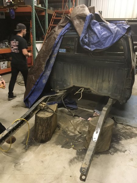

    Alright guys I have a few questions, I'm in the process of cleaning my rear frame and prepping it for my 4link kit, partially know what I'm doing on some of it and others I have no clue... IMG_0558.jpgwhat is that knuckle on the driver side frame I understand it's part :( of the brakes but I believe I can relocate it or delete? I need major help with the brake portion of the 4 linking and setting up the 4 links cycle... anyone chime in with what makes it easier, what I should do while I wait for the link kit... etc anyone that knows how to properly set one up... (ignore the logs they were temporary)

    thats the rear brake proportioning valve. I'd just throw it out and get a manual one. Front Range Offroad sells a great kit for it. And you can pick up a long ass new steel brake line once you know how long you'll need it. 30'' should be plenty though.
    Id go ahead a box the whole frame while you're there. And add cross members depending on your plans for a fuel cell.

    Grabbed a 32 gal jaz and I'm glad you brought that up cause I looked everywhere but nothing particularly useful in install one with lines and such... should I just trash the hardliners that come out the back side of the cab? Or..?

    Also what would I do with the hardliners from the brake just sitting there?

    The hard "fuel" lines coming out of the middle of the cab are for vacuum to the evap stuff, you will need those to keep emissions, or at least properly cap them or you will lose vacuum and cause all kinds of other issues. The other two lines from the middle of the cab that have the small rubber extensions are the fuel line and return fuel line. The lines for the brakes will need to be replaced, most likely from the master cylinder all the way to the rear wheels. You will need a flexible line at the front of the upper link so you can run down the upper link, then another flexible part where the link connects to the axle. I read its very hard to make the flares in old brake lines so thats why you will probably need to replace the entire line
