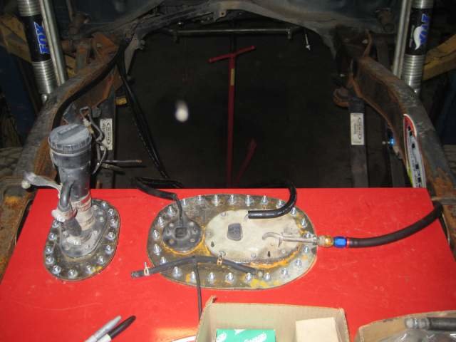

    The hard line goes directly to the carcoal canister correct? Should I get rid of the canister and pray for a nice smog guy or relocate it to the rear so I don't have to worry about mounting after I cut front fenders?

    I am not sure if your year is the same but a photo would have been a good idea lol. This is how mine was routed. For emissions if you want to be street legal in CA you need all of that stuff, some have said they found smog guys to pass but I'm not from CA so I have no info on that
    The easiest way I have seen from looking around you want a cell like this, where all of the fittings are in the fill plate. Then you can make a new fill plate and attach all 3 of the items mounted in the stock tank above into to the fill plate, and it will seal directly into the fuel cell. That way you can attach all of your stock hoses and everything should pass smog just like stock
    This has 2 fill plates but you get the idea

    Even in ca that technically isn't smog legal. Need a really friendly smog guy. A fuel cell would need a carb # for it to legally pass.

    Should, but sadly won't. Fuel cells fail the visual inspection. Its hit or miss if the place will pass you if it passes the "sniffer" test with a cell

    Well that's at least how you make the check engine light happy. Not sure how to make CA officials happy though :p

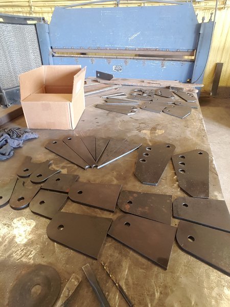

    Got some link brackets cut out on our table today.. JD designed them

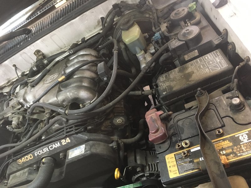

    That's the exact cell I got IMG_0564.jpgand my carcoal canister is in the same location as this 4 runner behind the fuse box to the right of the brake booster
