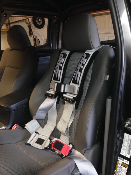

    How did you mount the harness im thinking of getting some

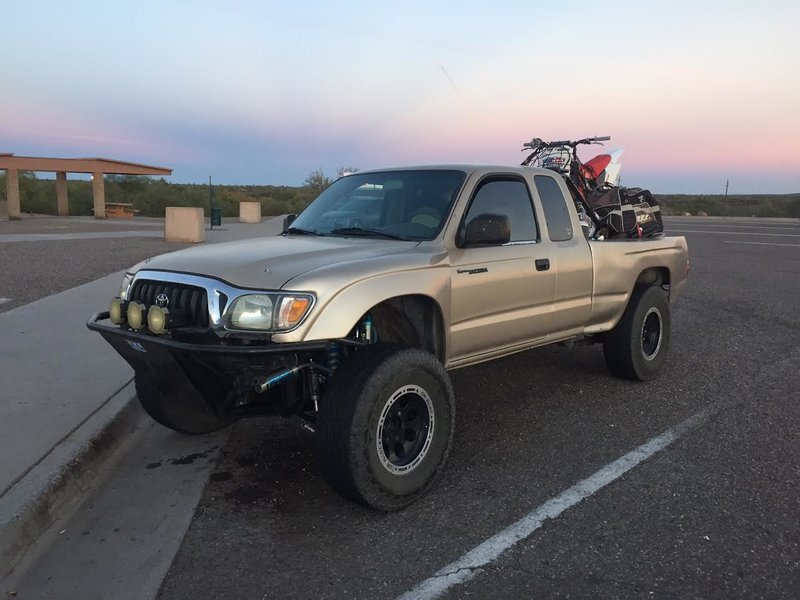

    Correct. All Pro makes the 50T but I am not even sure if they still make it. I had a set of the H70 Deavers and they were on my truck for about 5 years ?? and once they settled a little they never sagged at all. I loaded it full of camping stuff, 25 gallons of gas in the bed and a dirt bike and still had about 6" of uptravel left
    Just for comparison, unloaded after settled in 2012
    and unloaded in 2016, still the same ride height
