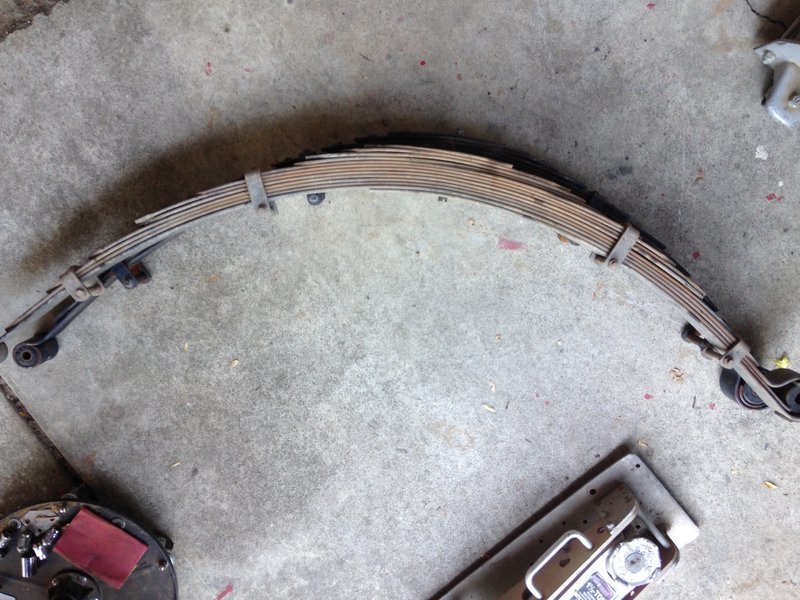

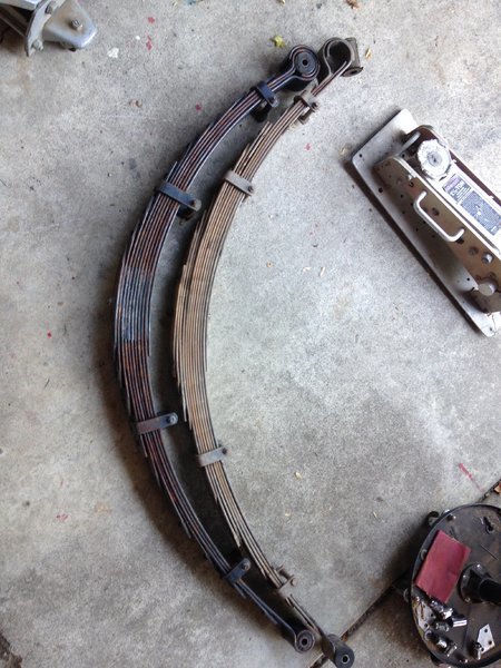

    My 50T's were about an inch longer at bump than my 67's. I had main leafs made and inch shorter to compensate.
    In case anyone is looking I have a set of mains for the 50T that is 2" shorter.

    50T vs F67. F67 is the dirty one. Not sure about the optical illusion but after I put the 50T's on the shackle was hitting the frame at bump.

    Ah makes sense...my buddy had to notch the frame to fix the shackle issue after he made the switch...I had to set mine to 53"
