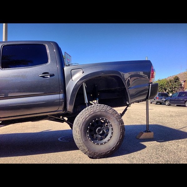

    Simple math. How long are the links and how far up the link is the shock mounted?
    For mine 48" links with shock at 26". So if you take a 14" shock the math would be...
    14/26 = x/48 and cross multiply
    14(48) = 26x
    672=26x
    25.84"= x
    So with a 14" coilover I would get 25.84" travel at the axle. This is linear and the links travel on an arc but gives you an idea. My links are for extra cab so your numbers are different but you can plug in coilover length and see what it changes

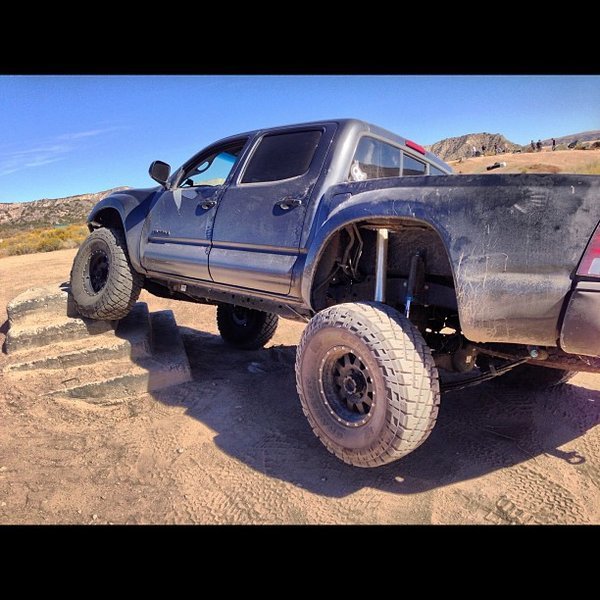

    51" links and heres a pic for reference. just know how long they are. he was swinging 20" with 14/14 combo

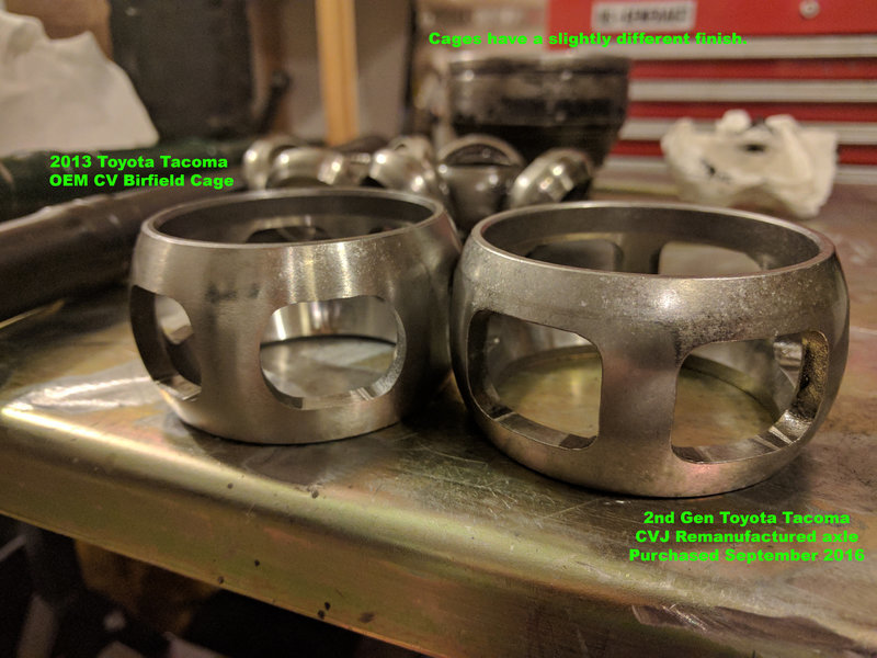

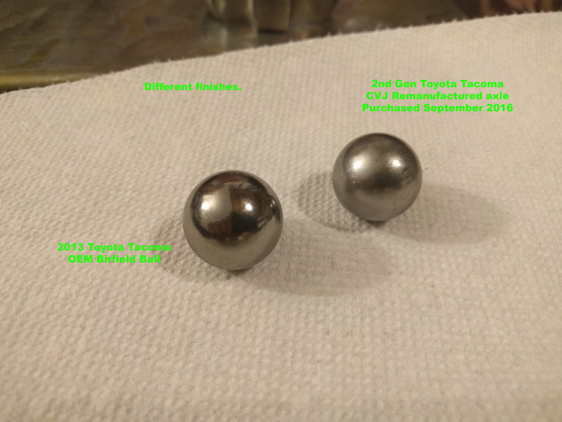

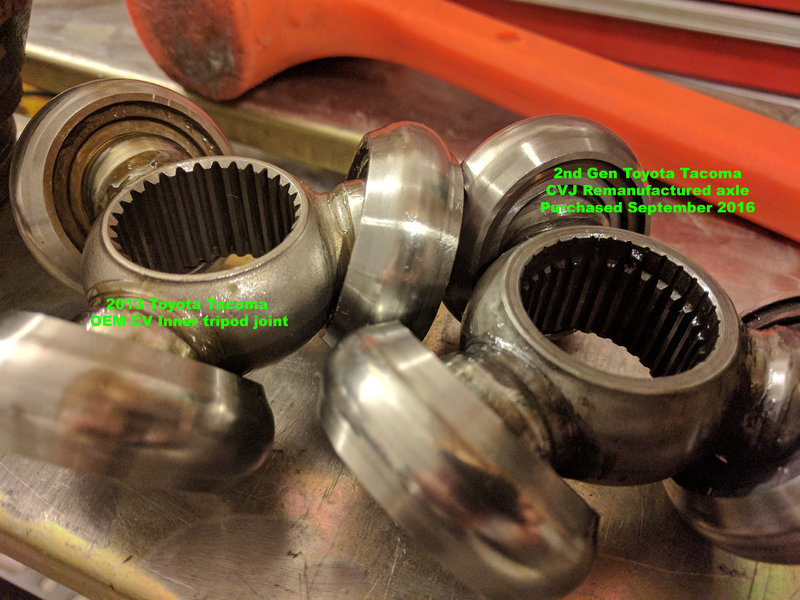

  4. Feb 23, 2017 at 1:47 PM
    tetten
    tetten Cynical Twat Waffle
    Nov 2, 2014
    #141581
    2,504
    Andy
    Socal

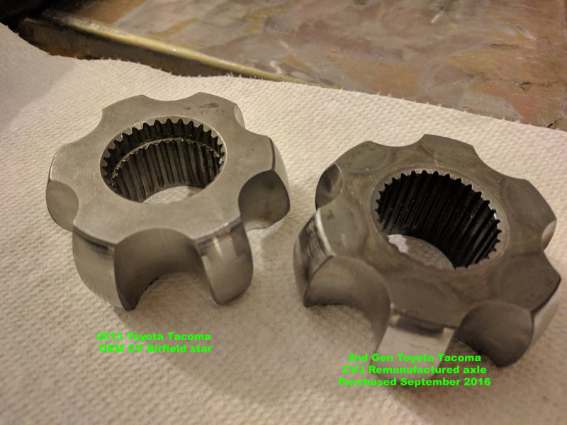

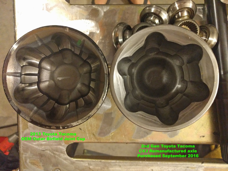

    OK here goes, some of these differences are very subtle like the finishes. That may be due to wear or the way the manufacturer finished the surface of the metal.
    The only things I don't have is an OEM axle shaft so I cannot compare a CVJ and OEM shaft, but I don't think I've ever heard of someone breaking an axle shaft. But it would be interesting to see the difference between the 2.
    I don't know where the difference in parts is coming from.....maybe they are older versions of the parts from earlier second gens? I am also wondering if CVJ is mixing and matching parts from FJs, 4Runners, and Tacomas to assemble these.
    I didn't notice any differences in the tripod cups.
    Also I didn't notice it until I posted the photos but the CVJ cage has larger windows and is slightly larger than the OEM cage.
    birfield cup.jpg birfield ball.jpg birfield cage.jpg birfield star 02.jpg birfield star 01.jpgtripod bearings.jpg

    If you angle the shocks enough anything is possible.

    He won't get much angle being a double cab, the shocks are pretty close to the cab. Its also better to set up the shocks to be at 90* to the trailing arm at full bump. It would be better to just get the right shocks

    I was being sarcastic. 20"of usable travel with a 14" bypass mounted that far back would be tough to get. But with no upper mount I guess the travel would be infinite.

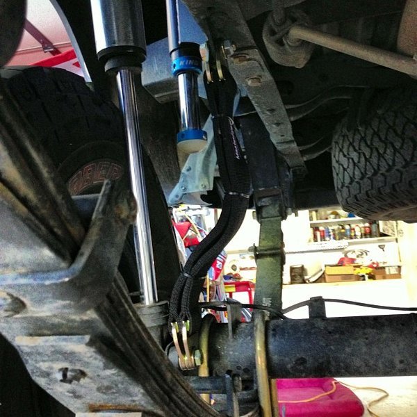

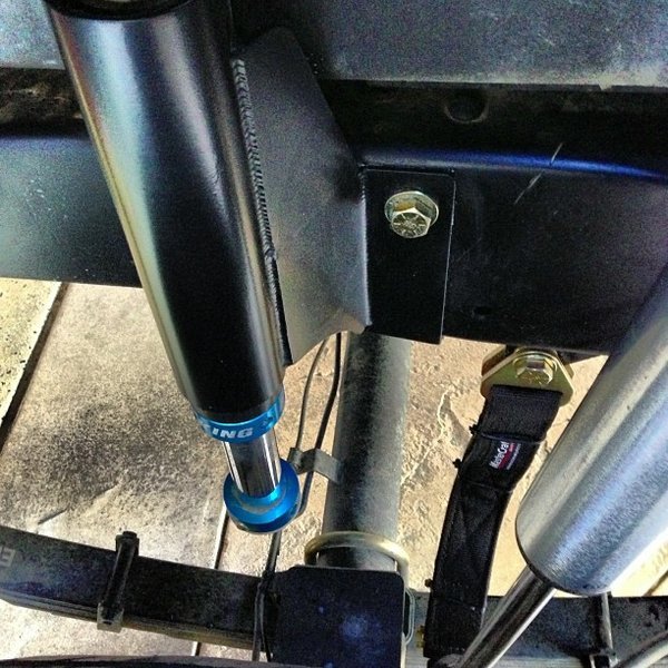

    Just curious, is your limit strap connected with the lower shock mount bolt?
  17. Feb 23, 2017 at 7:29 PM
    phillipthetaco
    phillipthetaco Well-Known Member
    Aug 6, 2016
    #193897
    637
    Marcus
    Mesa,AZ
    2007 Tacoma Prerunner Barcelona Red
    Wheels and Tires: (5) 35/12.50/17 Toyo R/T tires (5) 17” x 8.5” Matte Black Method NV wheels Black extra thread (ET) spline lug nuts Front Suspension: Total Chaos 3.5” long travel kit Fox 8” x 2.5” coilovers with remote reservoirs Wheelers Super Bumps Limit straps and clevis mounts Total Chaos shock tower gussets Total Chaos cam-tab gussets Maxtrac 4 inch lift spindle Larger Lexus rotors, calipers and brake pads Stainless steel extended brake lines Rear Suspension: DMZ Fabrication Spring Under Kit Fox 16” x 2.5” smooth body shocks with remote reservoirs Fox 4” x 2.0” hydraulic bump stops (shortened to 3”) Custom low profile bolt in bed cage (1.5” DOM tubing) Boxed frame from fuel tank back Custom tube rear cross-member (1.5” DOM tubing) Custom bump stop mounts and strike pads Stainless steel extended brake lines Performance: AFE cold air intake w/reusable filter Nitro 4.88 Gears w/heady duty seals Custom driveshaft with grease-able slip-yolk Odyssey Extreme battery Armor: Custom front tube front bumper (1.5” DOM tubing) w/custom skid plates and valance Custom rear tube bumper w/license plate mount and led light Exterior Accessories/Body: SDHQ “y-strap” for spare tire mounting Harbor Freight 1.5 ton floor jack w/quick release mount Fiberwerx fiberglass front fenders Fiberwerx fiberglass “TT” style bedsides Custom window tint and tint visor Retrofit style Headlights LED tail lights Custom black mesh grill Viper alarm Rigid Industries 30 inch amber LED Rigid Industries 20 inch white LED Rigid Industries D2 Blue rear chase lights X2 Interior: Pioneer touch screen head unit Kenwood mono amplifier Rockford Fosgate 12" P3 subwoofer Infinity Kappa door speakers (4) Weathertech front floor mats LED interior dome lights
    Yes sir
