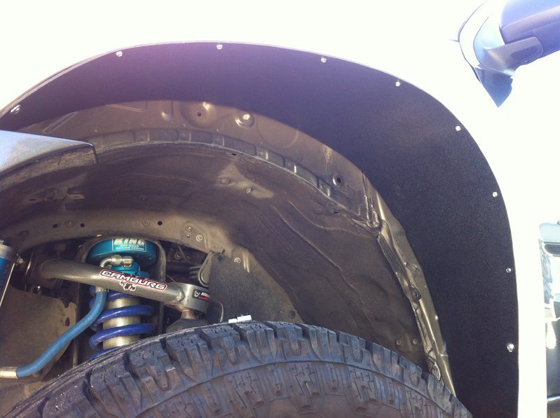

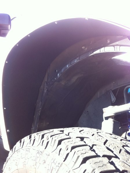

    When I asked him about them in a pm:
    As for the fender skirts, they are made out of .090" abs. I found a company here in salt lake and I bought a 4'x8' sheet for around $50.
    I made templates out of poster board. I bought these things called clip nuts? They are literally a clip with a nut coincident with the center of the clip (I'll have to find a pic). So I just used the inner lip of my Glassworks fenders and drilled holes at an equal distance. I also used some factory holes near the engine compartment that the stock liners used. My fenders are line-xed so the inner fiberglass lip is a little stronger over just the gel coated glass.
    The abs is your best bet. It is rigid as well as being flexible enough not to need a heat gun to install.
    I also went to Napa And bought one truck mud flap for $15 and made mud flaps for the front. This reduced the amount of mud, snow, rocks that are kicked up onto my side windows.

    I had the same question a few months a go and here's what I made.
    1/8" abs plastic sheets, 10"wide by 5' long.
    Made a cardboard template of the inner fender wells, followed by lots of trimming to get it where I wanted it.
    Traced it into the abs, cut it to shape, the mounted the front and back of the abs with clip nuts and bolts. Then mounted the middle with sheet metal screws.
