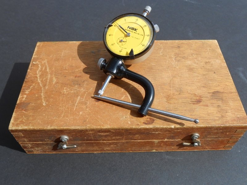

    Nope. They send shims but the only place they fit is under the bearings. Means another specialty tool if you want to pull the bearings off every time. Much easier to get the "washer plates" as Toyota calls them from Toyota. Only way to do it. Pit the new gears on. Measure back lash. Then guess what shimms you need. I buy the two I think I'll need to offset the carrier how I think then one up in size and one down I'm size.
    Guys who do it all the time just stock all 20 or 30 plates in the shop.

    you're doing the front? Clamshells just suck in general. Need the right tool to measure the back lash as you have to do it through the diff fill plug when the clamshell 100% bolted up. Then take it all apart to tweak it.
    If you aren't doing bearings though, it'll be okay, just tedious. Changing the pinion bearings SUUUUUCKKSS

    Ya. so normal dial indicator is a no go? Not changing bearings truck only has 30k miles

    not gonna work. You can't get a 90 degree contact on the gears, need the adapter for it.
