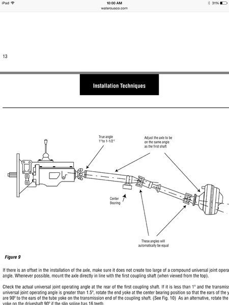

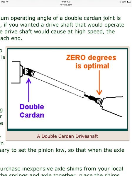

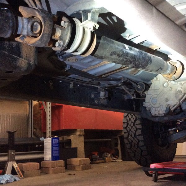

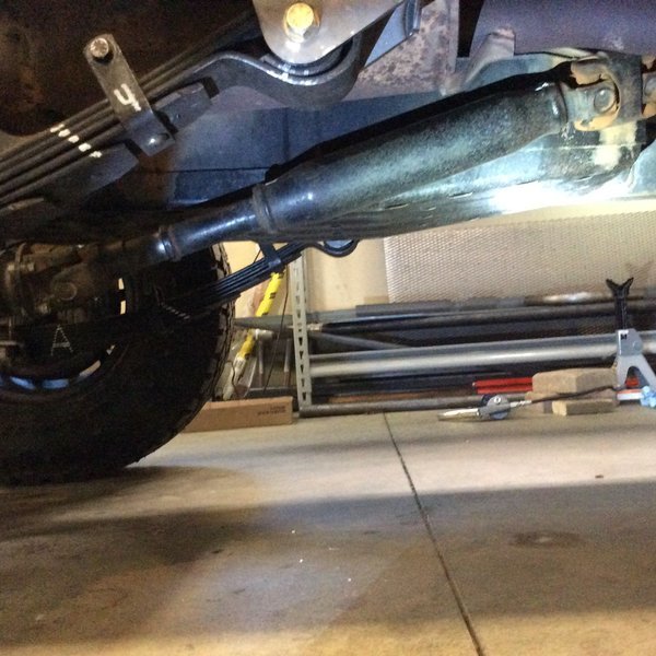

    To be certain ,I want my pinion pointed at the Flange nearest the CB.
    I currently have the pinion set to be Parallel with this drive shaft. (Pic below)
    I was using this diagram, correct me if I'm wrong. But this is not applicable when there is a CV ( Double Cardan) in the middle. (Pic Below)
    So I should go with this diagram (below) and point my pinion at the flange where the CV ( double Cardan is) and then lower 2*

    Yes. I would guess 1.5 to 2.5 degreee should account for any wrap on the springs
