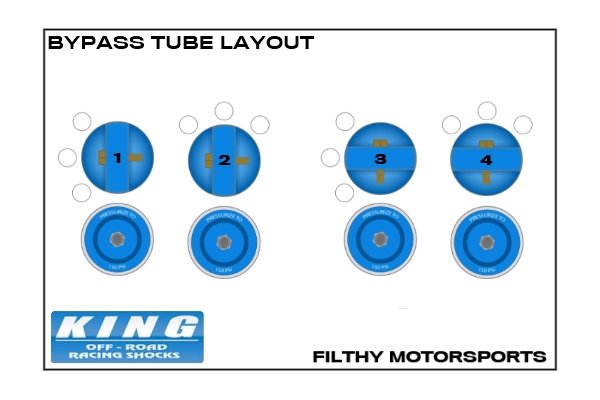

    Those of you with the running the dmz kit and bypasses, what's the layout on your bypass tubes?
    Anyone go with a custom layout? I want to avoid notching the gram if at all possible.
    Running 1.5" wheel spacers right now. Trying to decide between 2 tube or 3 tube.

    Layout 2

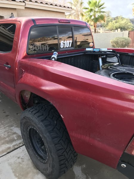

    This is the way mine was setup (3 tube) but the thing is mine is notched and i also have a rear bedcage so i dont really have to worry about the notch as much. But i was talking to a guy at solomotorsports and they mount bypasses without notching the frame, i think they used spacers or something idk but id give them a call. GL:thumbsup:

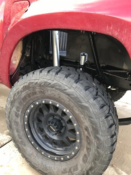

    Yeah it looks like we have similar bed cages. Just don't have too much room for activities left in the wheel wells.

    It's very simple. Buy kings in layout number two and you'll basically have the same clearance you have now

    I'm assuming fox has a similar layout. Going to be going with fox, through kartek. I guess I need to give someone a holler over there and see what's up.

    They do offer a similar layout
