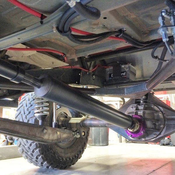

    Lol i know i need to take it out more, needs some small work on it..... so better just link it

    If u r the 8.4 non elocker it is the same third as the 1st gen tundra axle. It will swap right in.

    guy on instagram messaged med about if i wanted to buy a brand new in box set for 1500. ill see if i can find the message.

    I thought he swapped in the t100 axle then blew two 8.4 thirds w/5.29... If it was on the elocker diff then whateves we know they are not as strong as that extra .4" lol. But really they aren't from what I've read :)

    they are all really 8" rings.
    http://home.4x4wire.com/erik/diffs/ this is where i read up on everything for my crawler.

    Yeah I meant more the whole 8" third vs 8.4" third lol
    That said I had no issues with my elocker other than when I blew the stock set an ha to have a bad regear redone by Yotamasters. But after it was done right no issues and I beat on it, but it was 4.56.

    Or you could have bought the $100 one from Trail Gear that Poly Performance sells.
    https://www.polyperformance.com/Trail-Gear-Ford-9-to-Toyota-Drive-Flange-300843-KIT

    Except I have daytona bearings so it has to be machined different than a normal 9". I could have bought that and had it machined but I wanted to buy it from a place that could do the machining all in one. I wouldnt doubt the one I bought is a copy of that one though, it looks exactly the same but mine is like 3/8" shorter for the daytona supports

    or you could skip all the adapter nonsense and have a new driveshaft made since you'll likely need modifications anyway.

    Ok just chatted with Jordan he had two elocker thirds from ecgs with 5.29. They warrantied the first then after second he went with old t100 that had stock 4.90s till truck went bye bye.
    The more and more I think about the more I want 5.29s :D
