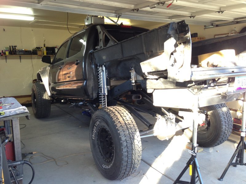

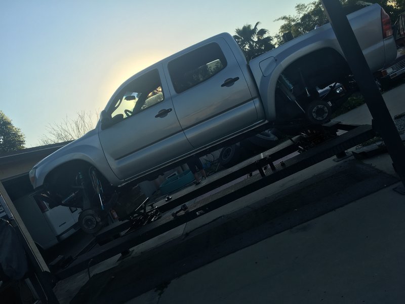

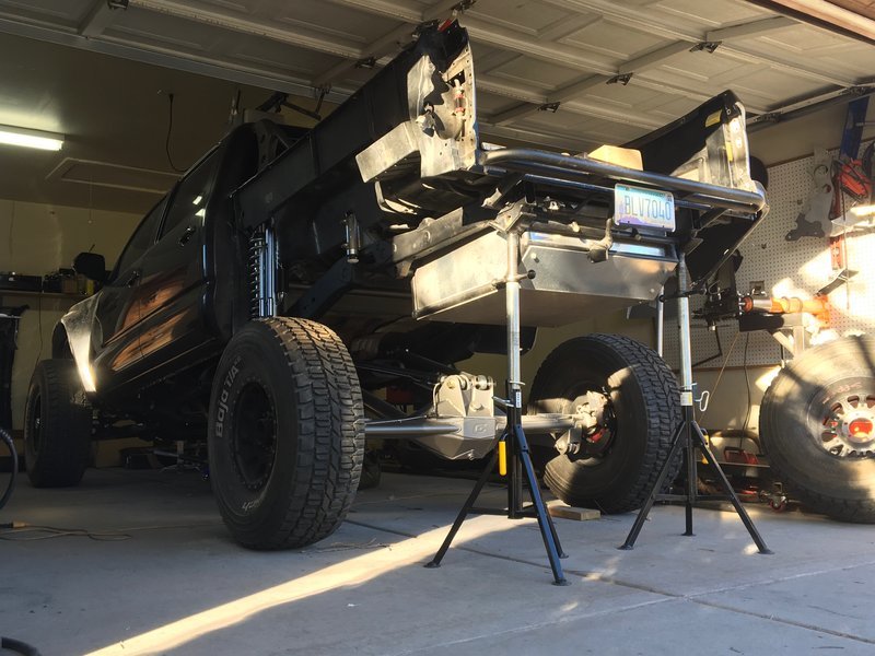

    image.jpg image.jpgimage.jpg Few inches short of full droop. All this talk about drive line adapters, I just had mine done. Retubed, 1350 yoke and put a seal on the slip yoke instead of a boot for $250 bucks. Done

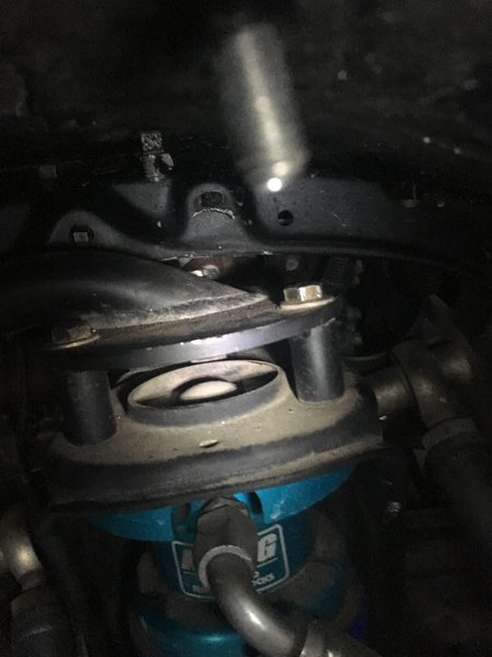

    Hey i have a question for you guys how do you re. move your coilover shock with the total chaos shock buckets i can barly reach the rear bolt. Im trying to get all 3 offimage.jpg

    Floppy head ratchet wrench should do the trick.

    Used a normal wrench it took for ever but it came off whooo

    yea the ratchet end ones are life savers for stuff like that. I love them.

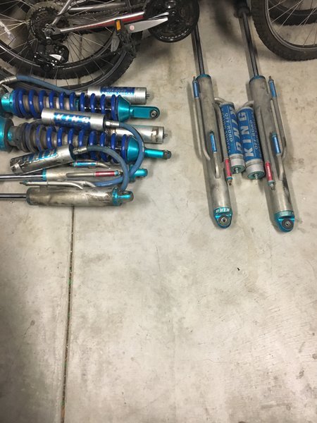

    I couldn't use that end lol I barley had room to put my finger over the bolt lol but i got them off. Im taking them for a rebuild tomorrow :bananadance:. They've been on the truck since 08 according to TC:DIMG_1275.jpgimage.jpg
