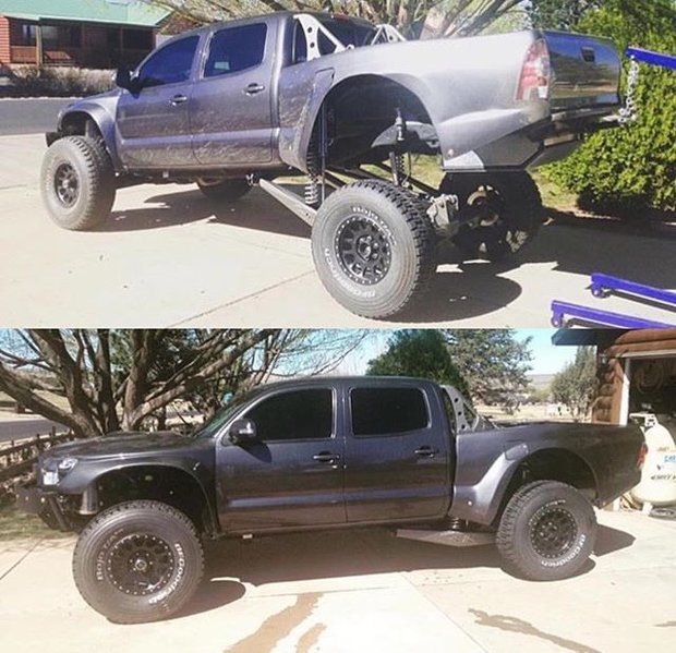

    image.jpg Trimmed front and rear no issues. Cut 3" out of the front all the way down and 4" out of the rear. You'll be fine. Definately line-x/rattle can Bedliner the inside of the fenders or they'll spider crack from rocks hitting them @erok81

    truth. Mine are near death from this haha
