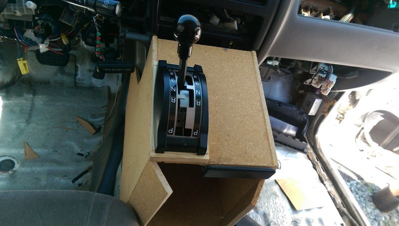

    What is being gained by using the th400 shifter. You don't really here about thes problems with the correct shifter.

    That's because most people don't make a console for the shifter. The arm that comes off the shifter is the same all around. And that was the shifter the was available and cost less actually and plenty of people have used it in the past. Including one of the employees from summit racing that informed me it can work.

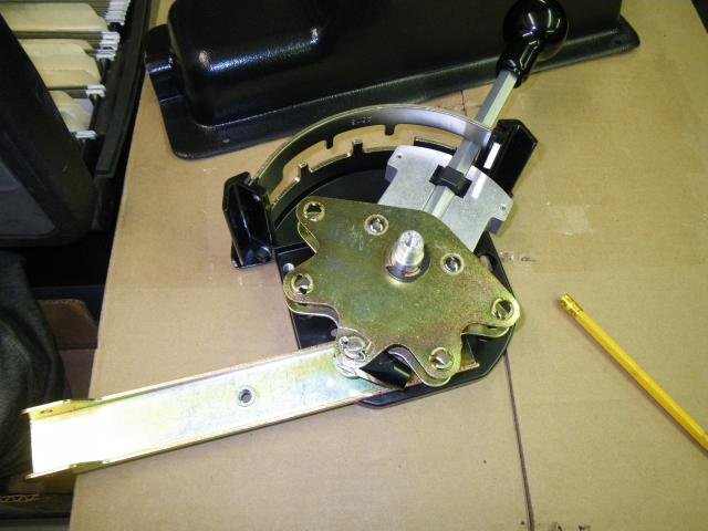

    You know you can adjust how the arm comes out of the shifter, right?

    I did not know that, thanks. This is the feedback I was looking for, not bashing....

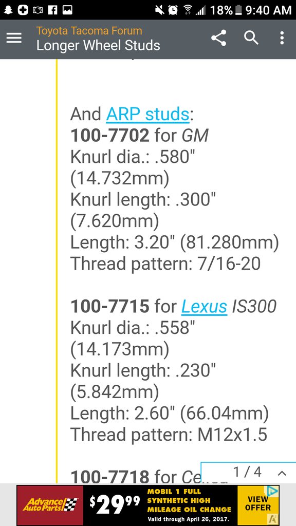

    arp wheel studs. Lexus is300 studs have the right thread pitch but the wrong size knurl. too small. seems the gm studs are right size, but wrong pitch.

    I run the IS300 studs up front with no issue. It you have what's his name build you hubs that's what he uses too, had him send me extras to swap into the rear axles when I quit being lazy

    the knurl is too small for the rears.

    id like to do a center console thats raised a little with a shifter like that, i dont really need 4 cup holders and the arm rest thing sucks. something like kibbie makes would be sweet.
