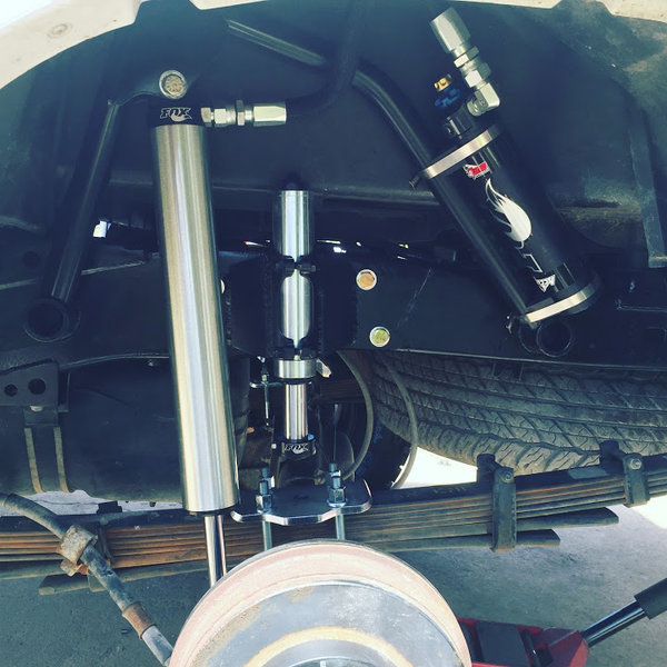

  18. Apr 24, 2017 at 9:38 PM
    paranoid56
    paranoid56 Well-Known Member
    Jul 25, 2012
    #83443
    3,443
    San Diego
    14 double cab taco
    anybody got any pics of how they mounted air bumps on the front? wondering if the stock lowers will work for that. finished up the rear and now need to move onto the front :D
    rear setup finished now :D
    sytfu510, J.Maynard, PapaBear and 2 others like this.
  19. Apr 24, 2017 at 10:06 PM
    nfs257
    nfs257 Well-Known Member
    Jun 22, 2011
    #58691
    7,530
    DFW
    She gone
    Stock lowers aren't strong enough for that. If stock replacement like TC's then bump off the lower.
    Airdog likes this.
  20. Apr 24, 2017 at 10:08 PM
    paranoid56
    Jul 25, 2012
    #83443
    3,443
    San Diego
    14 double cab taco
    yea, i was wondering about that, i wonder if i could just plate it for now, then wait for Camburg to come out with their stock lower. I have bumps just sitting here lol
