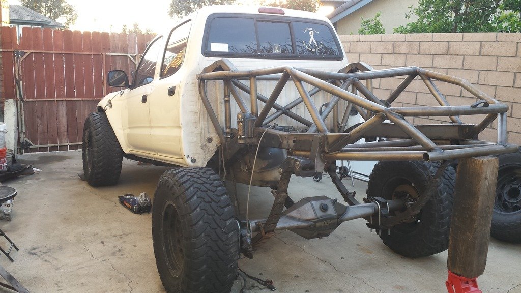

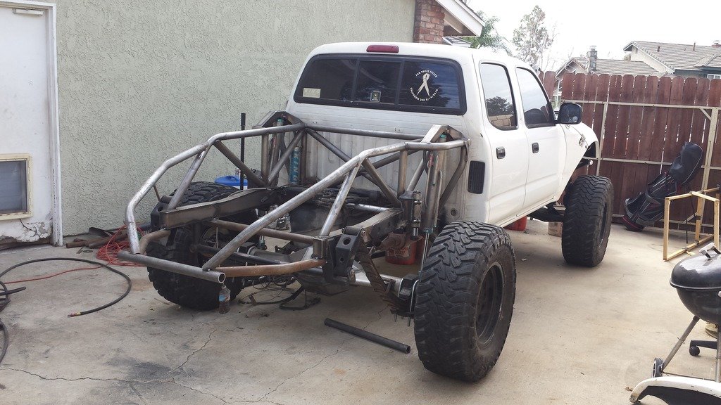

    yours was the link killer kit? i thought yours was just the normal Giant SUA kit..
    Yours didn't look like this:
    and i know you didn't have the bed cage like this and all that..but i mean the inverted shackles and all..

    Link Killer normally refers to Giant's "custom" shocks. Which basically just means a performance series king shock with a pure race compression tube (larger tube) but everything else is performance series.
    Giant sells a 62" and a 64" long travel kit. The 64" is inverted shackle while the 62" is a traditional shackle above the frame. I had the 62" kit...and replaced everything except the front spring hangers.

    I've seen that 64 kit do pretty good. Only seen it on hard core built trucks. They do complain that you can't put much power to the ground with the wheel hop. My buddy with an f150 even changed the geometry from what was recommended on it to help it even more. I think that kit you can get about 18" to 19" with 18" bypasses.

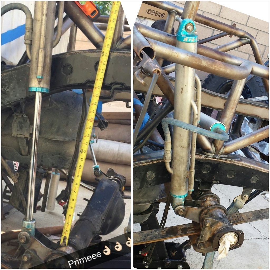

    Definitely a solid kit. Can't complain about not putting power to the ground because I still have the stock v6 but it does cycle 18-19" with a 16" shock. About 10-11" up from ride height. Cut off those stock bump pads and replaced them with hydro bumps.

    Was that your tundra axle in these pics?
