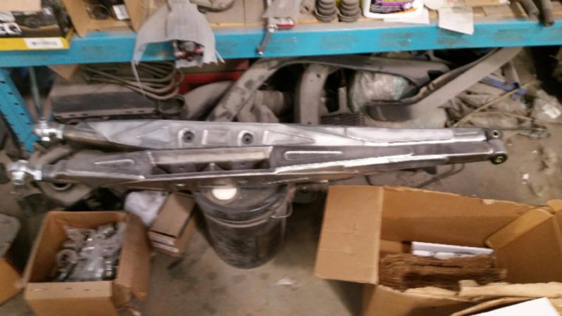

    Got these in today. Axle assembly is getting built up this week as well.

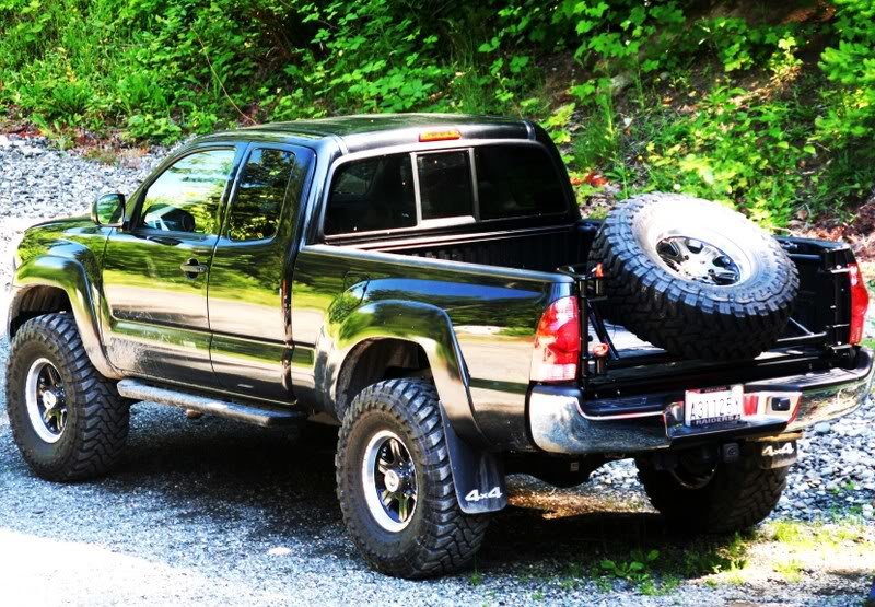

    Yeah I've got my spare in the bed now as well. I'm planning on doing something along these lines to have a swingout and not have the tire hanging too far out the back but also not take up the whole bed. But I also only have one spare. IMG_6136.jpg

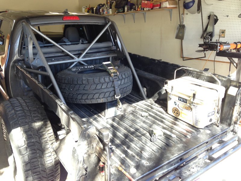

    image.jpg I perfer running it up front so it's easier to get to the beer. If your running 2 spares your pretty much limited to behind the axle unless you stack em on top of each other. Personal preference really
