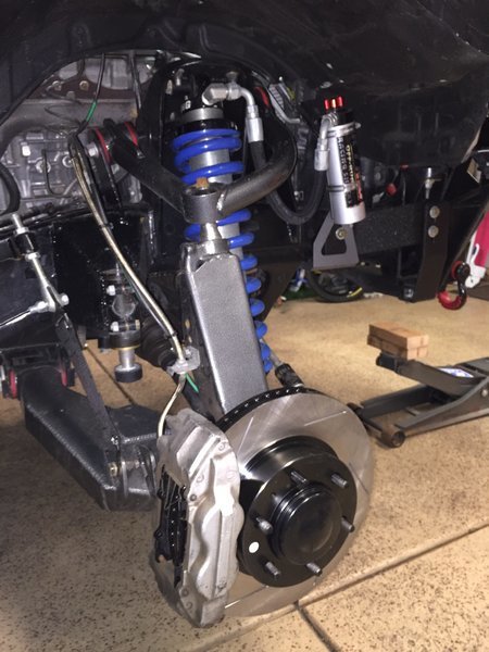

    5,368
    Coeur d’Alene, Idaho
    Just curious what your front setup is, I've seen your rear and its bad ass.
  9. May 13, 2017 at 11:40 AM
    glorifiedwelder
    glorifiedwelder IG= @Liquid_Torch
    Feb 14, 2015
    #148647
    3,658
    jason
    Santa Clarita, ca
    double cab trd sport
    When I talked with Andrew about the kit, he was planning on running oem inners and d44 outers. It looks like d44 snout in the pic. This kit is also +4.5 so it's gets some of its extra travel just from the width of the kit
    erok81[QUOTED] likes this.

    San Diego, CA
    06' DCSB 4x4
    Yes
    Just a Solo +2 kit in the front
