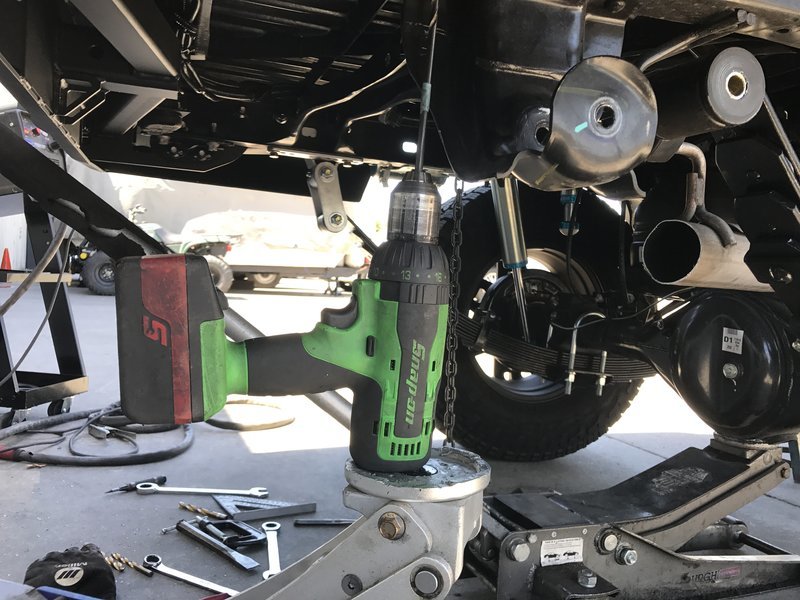

    I would try a smaller drill bit at first, but yeah, if you go that high there won't be much to hit. And if you go that high you might as well just drill it out instead of hammering it out. If you used a large-ish drill bit you could try a tapered punch and insert it into the hole and try to hammer it out that way, but you would need to be able to knock the rivet off the punch after it comes out.

    Chances are that your holes won't be perfectly centered. I'd be carefull just going for it with a half inch bit.
    If you drill all the way thru it with a 3/8 bit and grind the rivet flat at the minimum the hanger will come off the frame. You may have to grind the other an 1/8" more off the rivet once once the hanger is removed but it will come out with minimal force. I remove rivets from frames pretty much weekly. These days I use the plasma a lot more. It when I need to keep the part I'm taking off perfect I still do it with a drill and grinder.

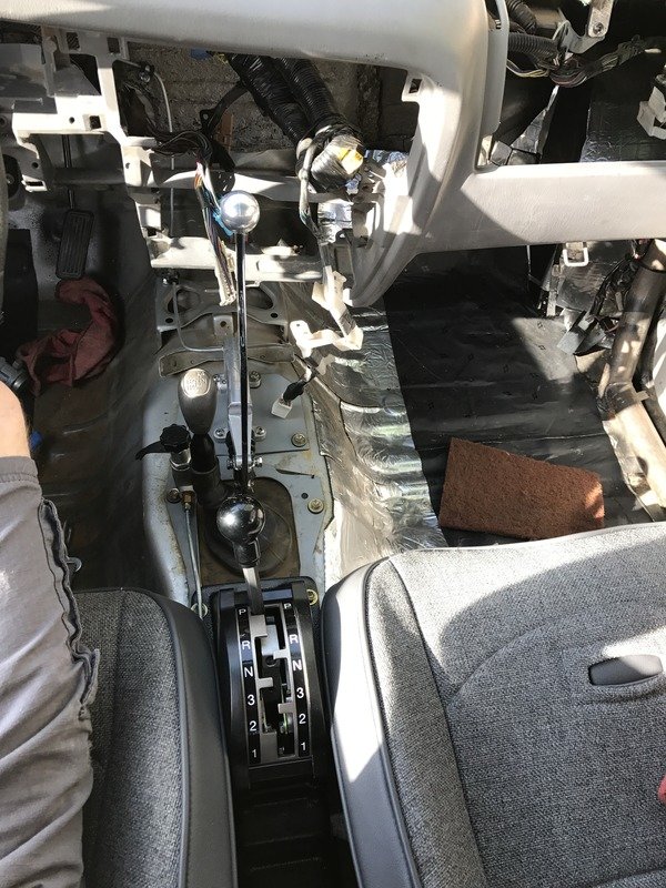

    Gotta bleed the brakes and buy a longer shift cable. AND need to figure out what dang wires to hook up to for my shift solenoids to get my RADesigns kit to work.
