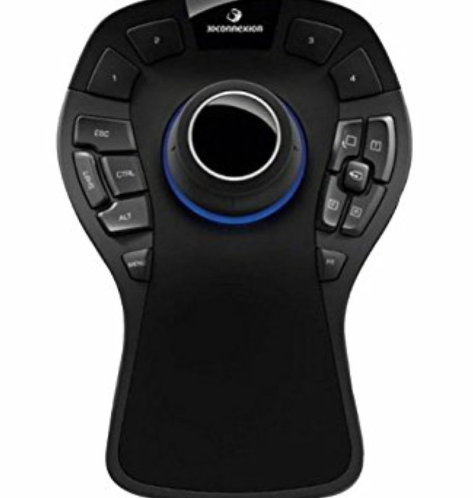

    Oh, and first thing you should do is setup your shortcuts/hot keys. Makes developing way easier and faster. It's basically the first thing they teach you when you take the class.
    And if you start using it a lot, get one of these. Having to use SW everyday, this things saves my life!
    MadTaco461 and ls1 prerunner like this.
