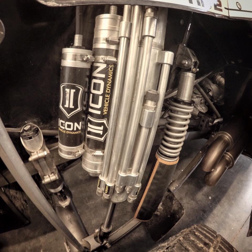

    Holy shit is that an Icon bypass?

    Haha I didnt know a thing such as an Icon bypass existed! Thought it was only myth.

    That's because that is the only owner of one in that pic *drops mic*

    ive seen plenty of icon bypasses lol

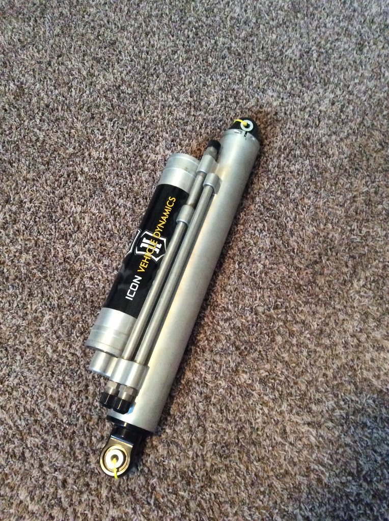

    I have 4 sets... :notsure:
    These 16" 3.0 4tubes are just paper weights right now waiting for some fresh shock mounts
    Think Jeremy McGrath has enough adjustment? lets see if you can wrap your head around that setup
    Icon will build you literally whatever you want, you just have to be patient.

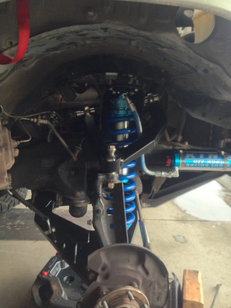

    One side done other than brake lines. Tear down the drivers side tomorrow and finish it up Thursday is the plan.

    I hope that's not where you're mounting your limit straps

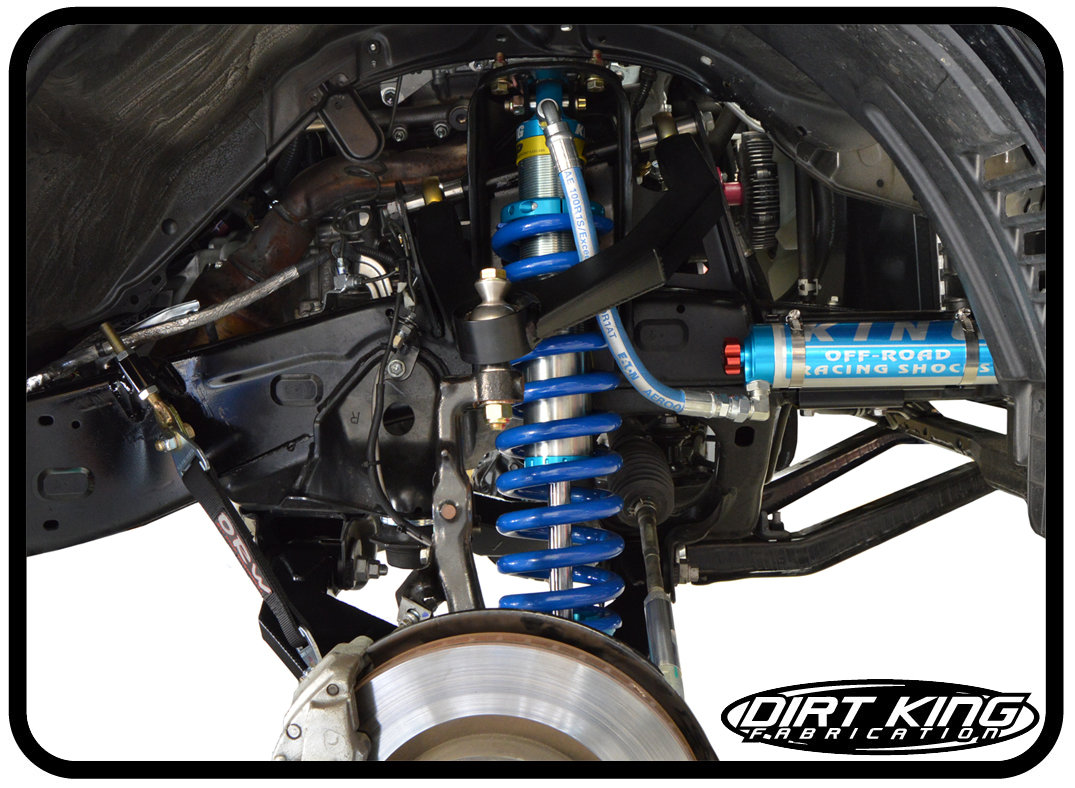

    That was the thought as mounting location instructions were pretty vague so I was going off of pictures. It's in roughly the same location as theirs here, but I'm assuming their tab on the preproduction kit may have been angles slightly different. IMG_6399.jpg

    Got my BajaKits kit installed with a few minor things but mainly the steering extensions weren't right but I sourced them from elsewhere. Also I broke the c clips on the inner axles so I had to hunt some down.
    Installed the cam gussets while everything was out as well. Same with new inner/outer TRE's. Hoping tonight I can button it up and drive it. I need to figure out wtf I'm going to do with this huge length hose BK put on these Kings. They're too long for the runner to sit where they normally do.

    That's going to do 1 of the following...
    Snap the lower mounting bolt
    or
    Break the welds for the mounting tab at the LCA
    Limit strap when taught, should be as close to a straight line as possible, from mounting point to mounting point (including where its welded). Pulling things at an angle like that increases the leverage and leads to premature failures.
    Also......
    WTF is up with the upper clevis mount in that DK photo? How hard is it to get a double shear adjustable clevis in there?

    Find a hose store near you and have them make you a set. Cheap and easy.
