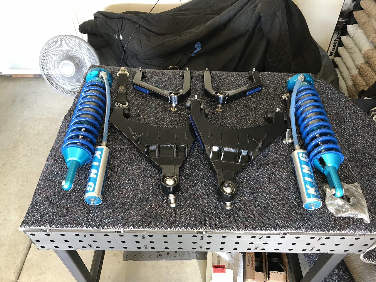

    Did you get your Baja Kits setup from the group buy that just happened or did you get it from another source? I put down my deposit for the GB on Monday, so now it's the waiting game for them to say it's ready and pay the rest.
    Caboose117 likes this.
  6. Jul 15, 2017 at 1:14 PM
    LTDSC
    LTDSC 32oz of fun
    Apr 7, 2013
    #101544
    13,385
    Sam
    NorCal
    I snagged @Dalandser BajaKits kit a few weeks ago.
    I was going to buy in the GB but this one popped up and couldn't pass it up.

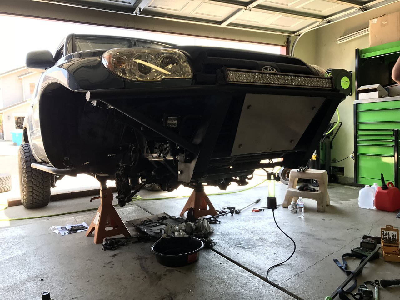

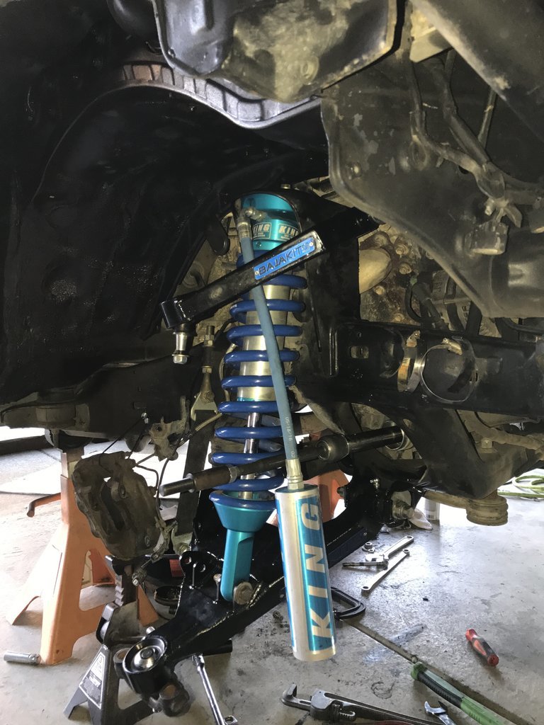

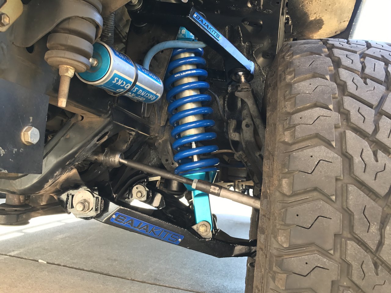

    Cool. What were you saying about the steering extensions not being right? Did you not get the steering extensions that come with the Baja Kit setup? Did you get them but they didn't fit? Or did you buy some from somewhere else and they didn't fit? How were their instructions?
  8. Jul 15, 2017 at 1:31 PM
    LTDSC
    LTDSC 32oz of fun
    Apr 7, 2013
    #101544
    13,385
    Sam
    NorCal
    The steering extensions from this kit was for a Tacoma as that's what the previous owner had. I asked BK if it'll fit without knowing myself if it would. Ended up being an M15 not M16 like tacomas. So obviously it didn't fit. I had to order from another company that actually makes them for the 4runner's.
    I now have two sets of Tacoma steering extensions if anyone ever needs one.
    Didn't have instructions, it's pretty self explanatory if you've worked on your suspension at all. I already knew how to remove and swap axle shafts so it was easy just takes time.

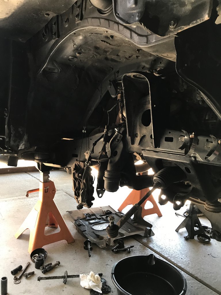

    You won't get any instructions w/ BK unless they started sending some. I was only sent a picture of the steering stop removed. Take off all your suspension components, put the spindle on something to keep the brake line from having weight on it, put lca on loosely so it's just hanging, put the coilover in from the coil bucket, hook it up to the lca, connect the spindle, and install the uca. There's no way to torque the 4 spindle bolts (at least the three on the bottom unless you have like 2" backspacing) with the truck on its own weight but you can torque everything else with the truck on its own weight. That's the way I did it at least. The uca bolt is the hardest part - not hard as much as it is a game of observation, patience, and feel. You'll need reservoir mounts for the co's. Install them last to make sure the hose isn't rubbing on the uca or coil spring. They'll be most likely to rub at full droop. I got these:
    http://www.4wheelparts.com/Fabrication-Tools/Synergy-Manufacturing-Weld-On-Reservoir-Mount-Kit-4019.aspx?t_c=86&t_s=527&t_pt=101478&t_pn=SYN4019&utm_source=google,google&utm_medium=cpc,cpc&utm_campaign=shopping&emlprox=out&ppcfon=1&gp=1&scid=scplpSYN4019&sc_intid=SYN4019&gclid=CjwKCAjw-qbLBRB7EiwAftBCIyfcAK_bAJa510Xfl-Lqa4K24IonUoYb_wcvPDxov8Gx7LApaGJkuRoC-E0QAvD_BwE
    You may be able to find some for cheaper. I'd get some better brake lines and clevises for your limit straps (some shorter limit straps too). The brake lines with mine wouldn't fit the clips to hold them to the hard line bracket and had two compression fittings instead of just one.
    Here's a video explaining the uca bolt removal:
