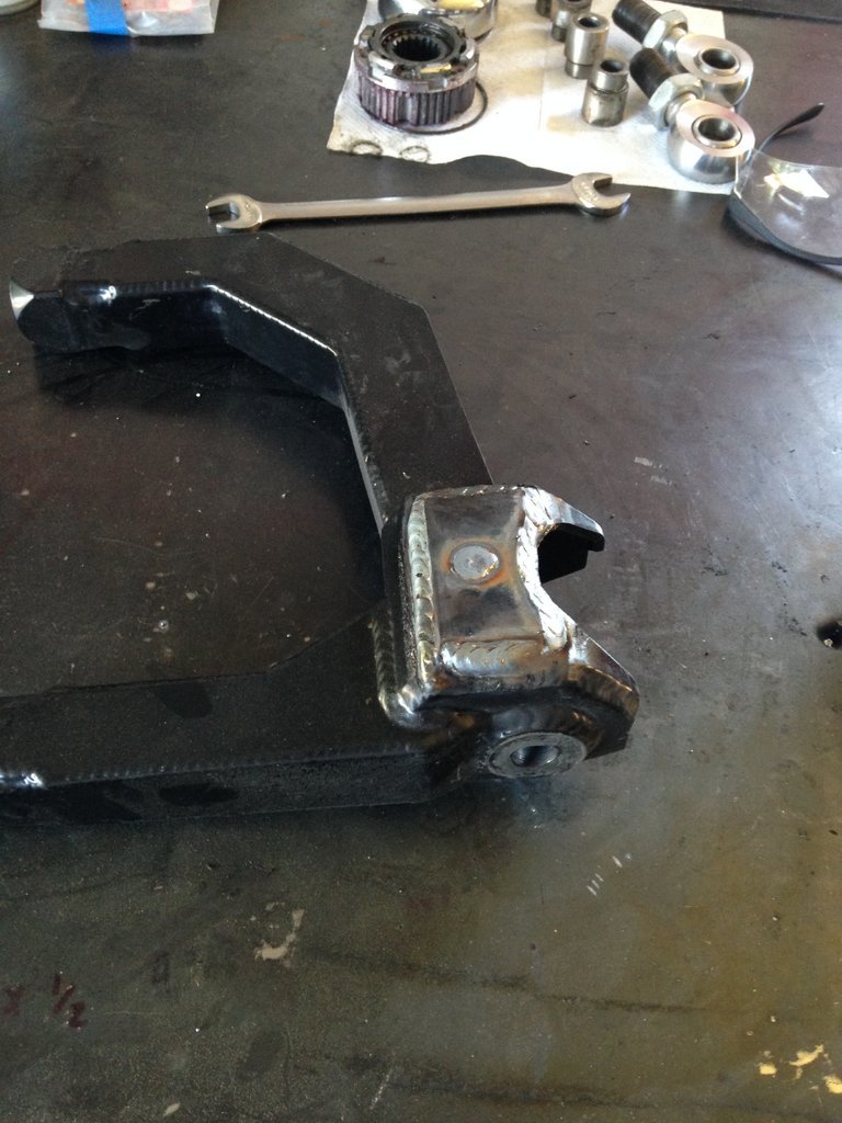

    Any valving gurus here? I'd like to valve my front c/o's to get me by until bypasses come in. Front is fox 2.5 and is WAY soft. Not sure what's in them, whatever they came with. Would like to get it to keep up with the rear somewhat and at least be able to huck it without doing this :anonymous:IMG_4198.jpglike I said, it's way too soft for my driving. Added 1/4" pad to keep that from happening againIMG_4278.jpgi have zero knowledge on valving so please dumb it down as much as possible lol

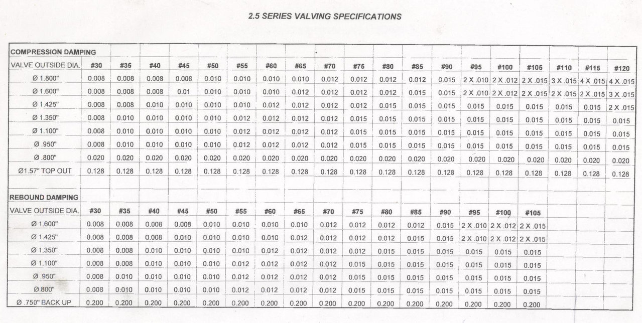

    Ha
    Werw the foxes new? Look and see if they have any numbers etched into them. It would be nice to know what valving they have in them to start with

    That plate looks awfully thin for a bump stop pad don't you think? Or the pictures make it seem thinner? The plate will definitely help. My knowledge is vague, but I see you have a tender spring, what main spring are you running? Maybe it's too light?

    If they were new they should have the valving on the receipt or you could call them and ask.
    For a single coilover I would start at #100 on the comp when looking at the fox valving chart. That's minimum, it will still probably be soft.
    If it was my truck with me driving I would be at 115 or 120 haha

    I understand that they set ride height but why do some of the TT guys change spring rates when tuning the shocks? I guess I'm comparing apples to oranges here. But just as an example, if your truck is too soft, would you go with .020" shims or thicker/doubles or would you go up a spring rate?

    It was 1/4". Now it's 1/2"

    They are fine tuning things to get the truck to handle/react in different ways, in this situation he needs to get the valving set right first.
    If you are too soft with 20's then I would try going to a rate plate. Stiffening up springs is last resort, you will sacrifice ride quality on small chop doing so
