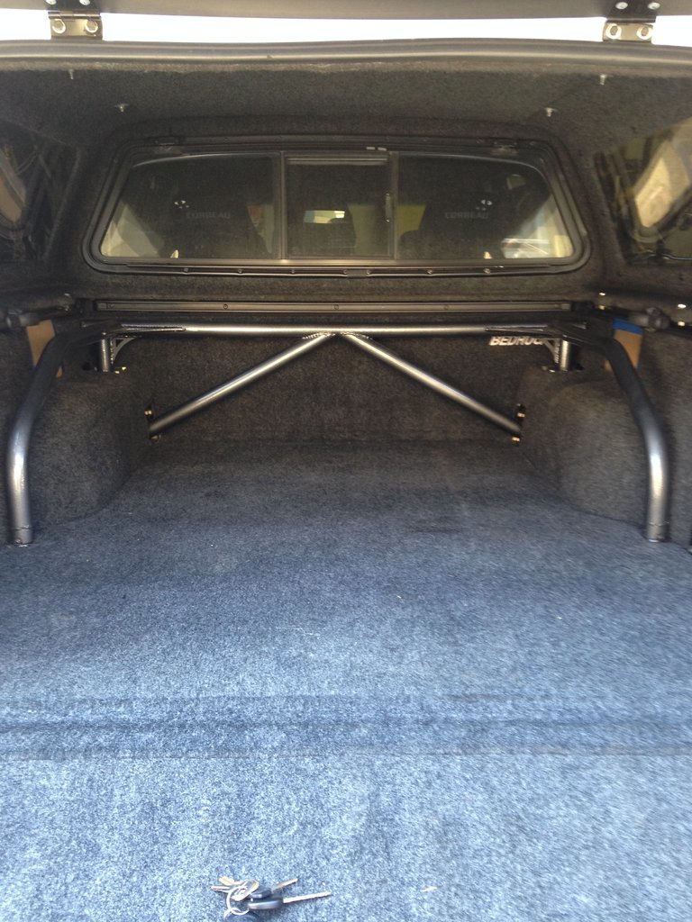

    So anyone running spring over axle with LT front and happy? I am torn right now after installing my +3.5" kit up front. My rear is 2.0 12" kings after a shock relocation but they don't even come close to keeping up with the front. Micah at dsm says upgrading to a 2.5" bypass will make a big difference and my leafs are shot so I'd go with a custom pack from deaver, but i just don't know if I'm gonna be happy with that. I love the soa with u-bolt flip keeping the bottom of the axle clean for rock crawling, and the 12" shocks do give a good amount of travel, but I just don't know if it can be enough. And I don't know if I necessarily want to spend 2x as much to go sua since I refuse to go through the bed with a bed cage since I utilize the bed on a pretty regular basis.

    My vote is to link it and be done. Look at how many guys go from soa to sua to links. Lots of wasted money in the mix

    Yeah I'd take a ultra 4 dd that I can throw a dirt bike in the back of if it existed. I'm just trying to be realistic and justify the 4.5k vs 2k and weigh the benefits.

    Yes
