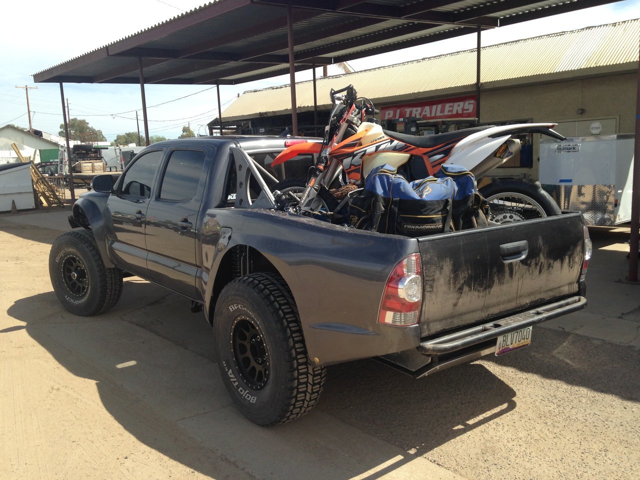

    IMG_4025.jpg @snowsk8air2 at least 500lbs with a couple inches of squat. Zero preload on coilovers

    I can chime in a little...I got the TC3.5 front and have relocated 12's with bamf brackets with the TC SUA. The rear works decent for what it is, but def cant hang at the 30ish range on the trail as its much firmer just doesn't cycle obviously to the same extent. My recommendation is to go SUA/links over staying SOA. I am looking to swap my SUA to a DMZ one hopefully around Christmas time and will eventually drop in 16s. Many guys who are 2+ can get away with the SOA rear because I think the travel limits with it make it more balanced. With 3.5, I don't think you will be happy until you upgrade. To get 2.5 bypasses with SOA is a waste IMO since your rear will never match the front with that set up and bypasses are made for that perfect tuning that might not be able to get with your current set up that would marry up well with the front.
