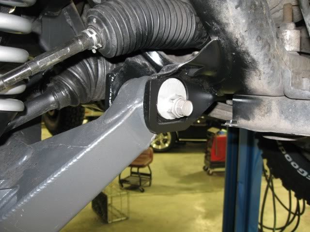

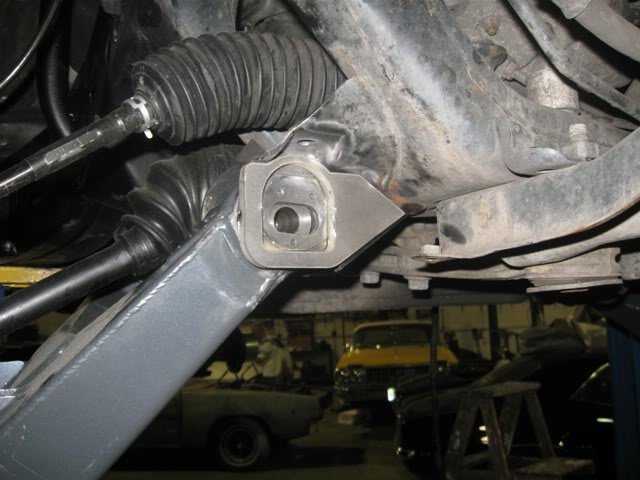

    Any of you bro's gusset your cam bolts? Mine keep adjusting when I wheel the truck hard in the desert.

    yup, i've got my cams tack welded in place

    I've been meaning to respond to your PM. Mine are reinforced using some custom 3/8" cold rolled steel that also reinforce the LCA mounting tabs.

    Lower arm mounts are much easier to redo then add to. Get rid of the stock crap and design something better for the mounts that have only a set location for the bolts. But don't do it if your UCA's aren't on heims otherwise you won't get to align it as easily.

    thanks man, but can you adjust the alignment after that? Looks like the cam bolts can't move at all. What if later down the road I do LT on my truck and require to adjust the cam bolts, but can't b/c they're tacked in.

    The cam bolts can still rotate in Mikes set up. If you tack the cams in place, and need later adjustment, you can grind off the tacks.
