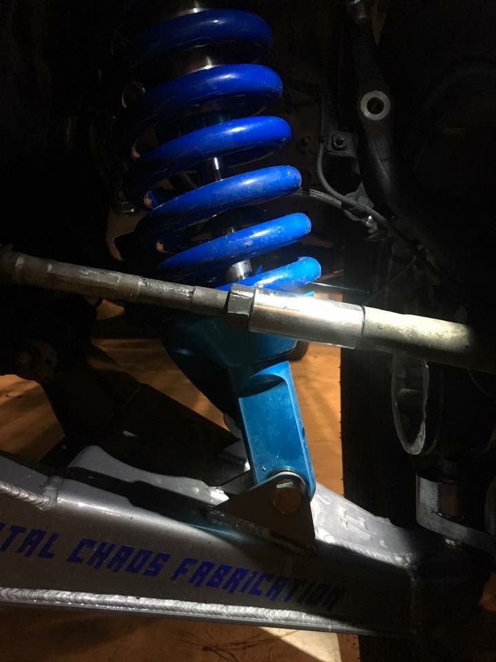

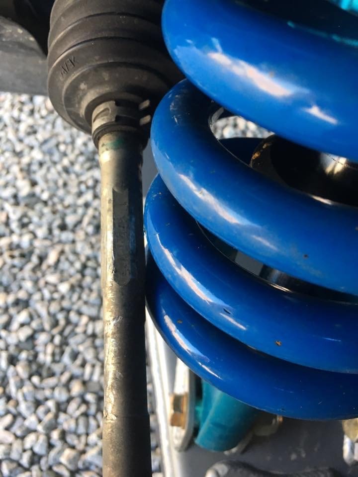

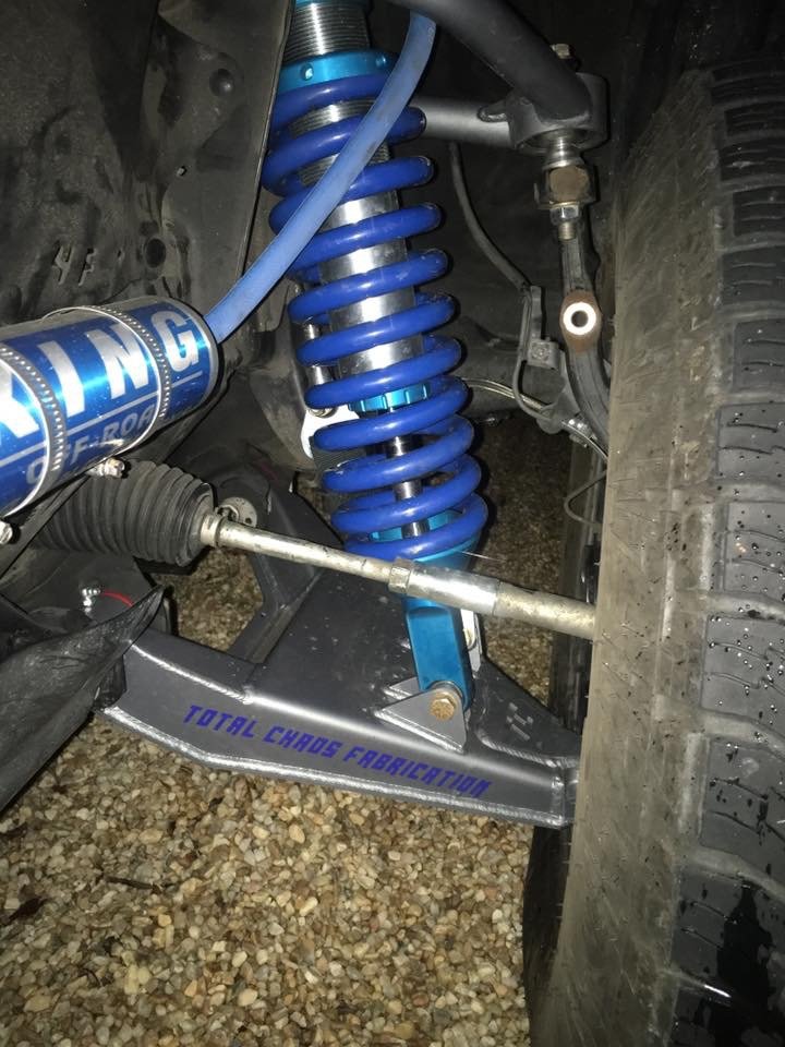

    Hey guys any idea whats going on with this TC kit... Its for an acquaintance on FB.

    Yeah that dude has like 5 people telling him the lower mount spacers are backwards on instagram
    Also he has no room to adjust the tie rods in :D

    That was my thought right off the bat. Swap the lower shock spacers. No need for middle clearance for a CV

    He has CV's they just aren't in there right now
