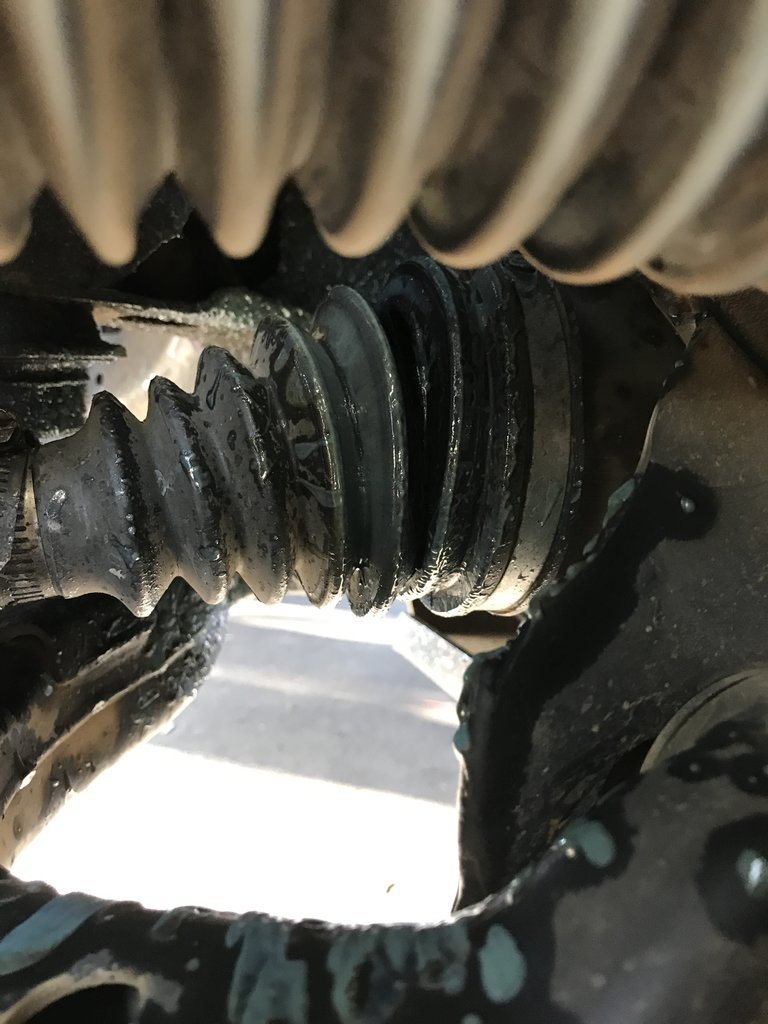

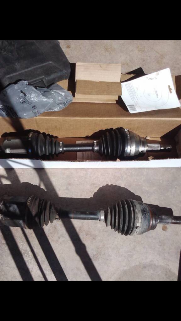

    I bought my cv axles from napa (reman)
    The top is the napa
    It looks like a oem Reman to me ? Unlike the vatozone
