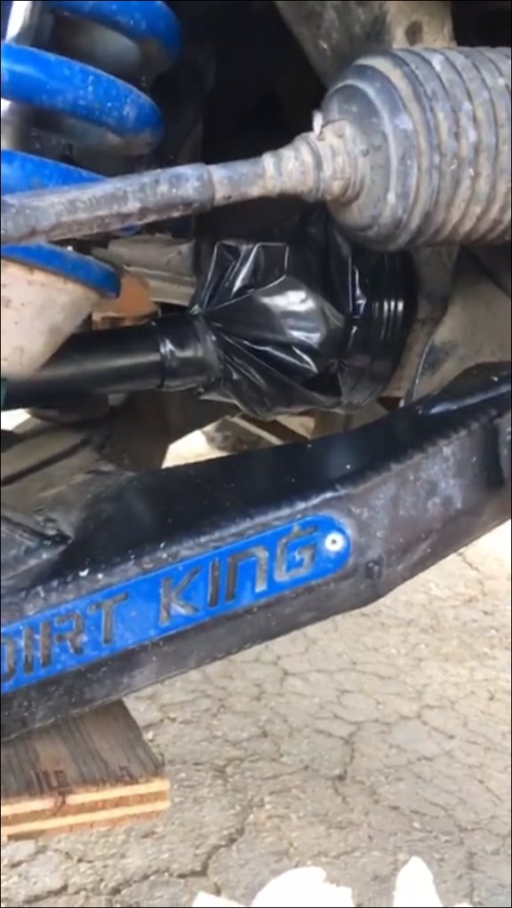

    Yes tie rods are all the way tightened or "all the way in"
    The tie-rods are in front of the wheels, meaning when you tighten them, it pulls the toe in, when you loosen them (make them longer) it pushes toe out.

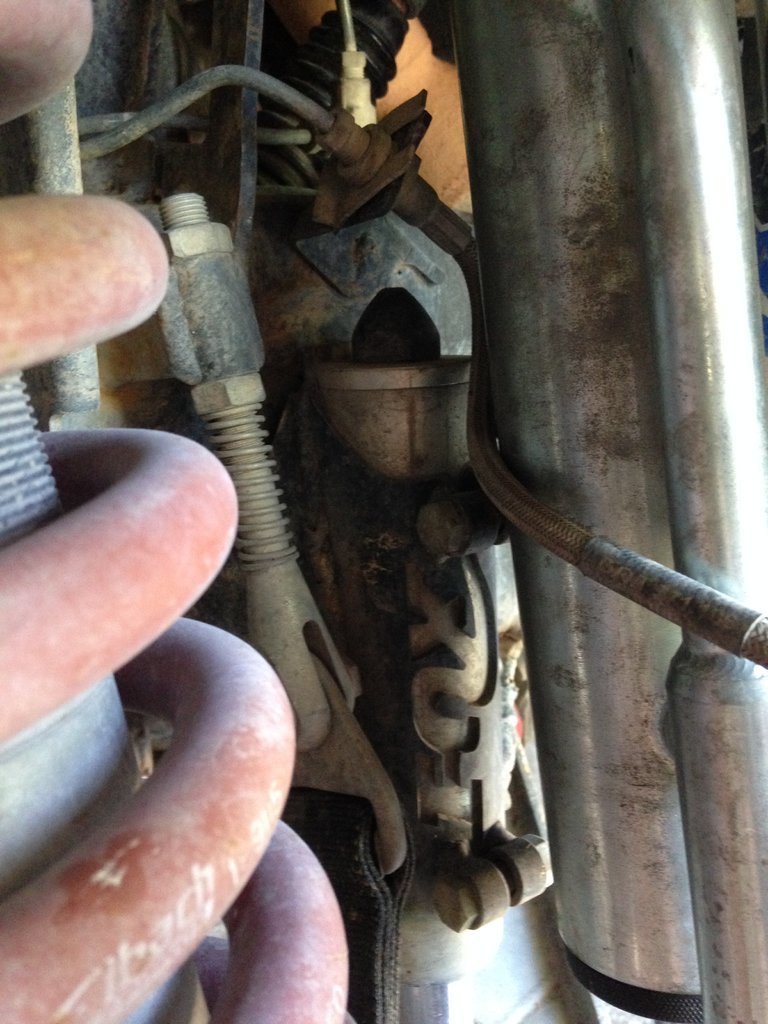

    IMG_4025.jpg @snowsk8air2 at least 500lbs with a couple inches of squat. Zero preload on coilovers

    jason
    Santa Clarita, ca
    double cab trd sport
    Have you adjusted your alignment cams? They push your wheels out effectively making the tie rods shorter
