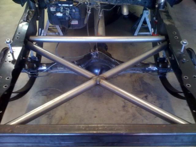

    In prep for long travel build I'm boxing the rear frame in the next week or two. I may or may not be cutting out the tire carrier cross piece. Can anyone have any advice here. Should I have something like this with or with out the tire cross brace??? Thanksimage.jpg

    Yes, do it and get get rid of the tin foil cross member there.

    https://www.tacomaworld.com/threads/2nd-gen-frame-box-plate-kit.405001/

    DMZ used to maintain stock tire carrier piece on 2nd Gens but reinforce them with extra overlay plating.
    Other guys eliminate them completely and add in something similar to the X photo you mentioned.
    Just remember if you eliminate it completely, you need to tack weld a crossbar to keep the rear frame from tweaking after you unbolt the tire carrier. The frame is so weak without the tire carrier that you can move it up and down by hand.

    Good info thank you!
