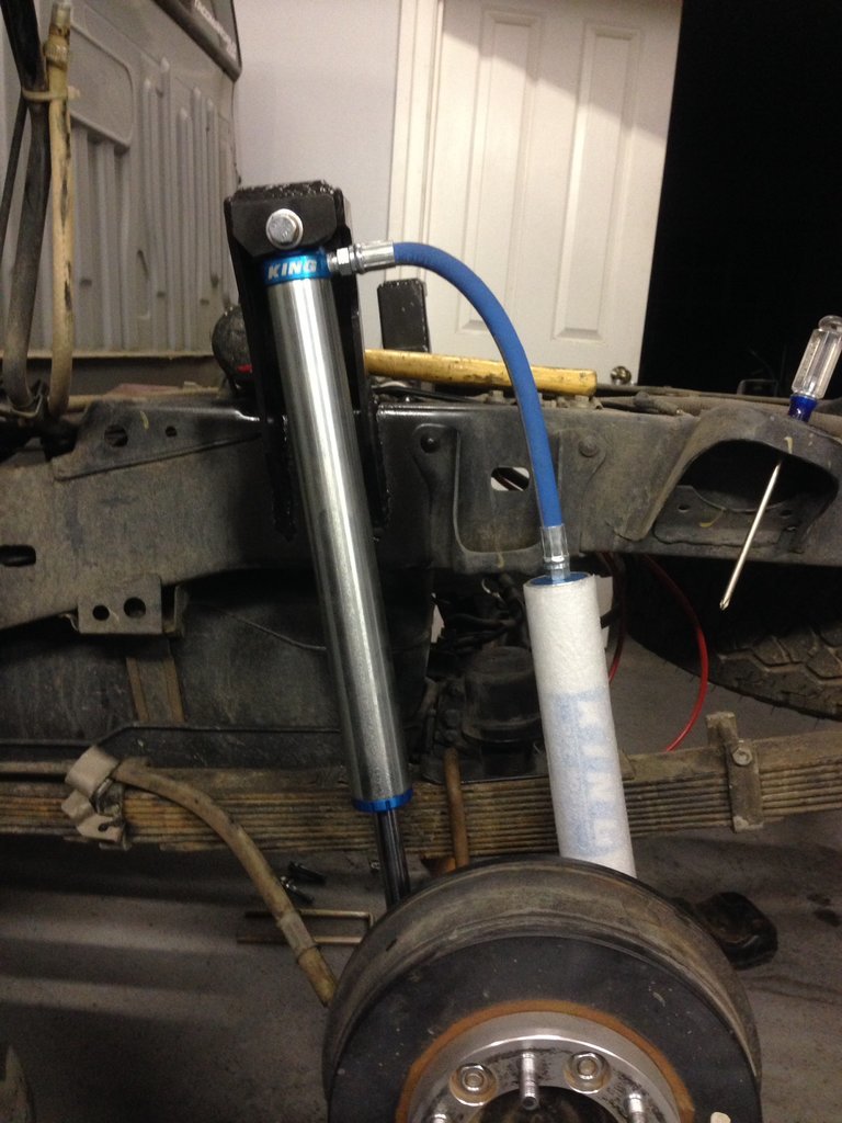

    Not sure if its possible to order some, but I reused my "Baja" mounts that originally held my billy resis. They fit perfect on my King 12 inch smoothies.

    I'm getting ready to pull my bamf towers off as soon as my LT gets here. Not sure if a piggy back would fit, but a remote resi will. If I can pull them off in salvageable condition I'm gonna try to sell them IMG_0840.jpg

    Yea just do a hoop in the fenderwell... u can fit all sorts of stuff up in there, I did mademan925's bypasses

    Total chaos makes a bolt on shock hoop for 2nd gens.

    Could possibly weld the lower shock mount lower on the axle or get a shock with a welded rod eye, no idea how much success to be had with either of those, but they may help squeeze in a longer shock
    Or for the cost if those hoops, buy a tubing bender and die and make his own :eek:

    But yes, could lower the lower mount.

    That's not true.... a 10" would be too short

    we have a bender might just make some but asked to see if there was any similar. ill never buy TC stuff, too over priced. figured if i have 12s mine as well use them.

    I'm getting about 11.5" out of my set up soa with the bamf kit and 12" shocks. But it took a shackle flip kit as well. The limiting factor is the leafs for me.

    Most SOA setups cylce 10'' or so when setup properly. Your option is to have a 10'' shock and strap the axle. Or 12'' and potentially either bump the axle short or move the top mount into the bed.

    I got the TC mid SUA in my rear and with the BAMF relocation I was able to route 12s in there. TC said that if you use their shock hoop, it is set up for 10.5 inches. I guess you could throw a 12 in?

    That's because it's designed to fit bypasses on their sua setup which has about 3-4" more bump travel than an soa setup. It would clear 12's with soa. They run 10's with their sua because the way the inner wheel well tapers away from the frame rails at the top it would push a 12" shock out a little far with their sua setup requiring aftermarket wheels as well as wheel spacers.

    Jk but yes definitely goes negative at bump. Not the end of the world if you're doing more crawling or expedition stuff. But not good for high speed and using a lot of your up travel. I was just trying to say you can get almost all of your 12" used in a soa set up and have it function well. But there is a reason I am switching to LT and sua
