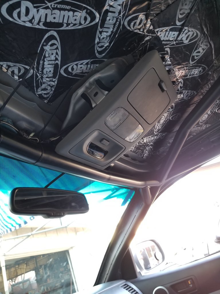

    another one done.

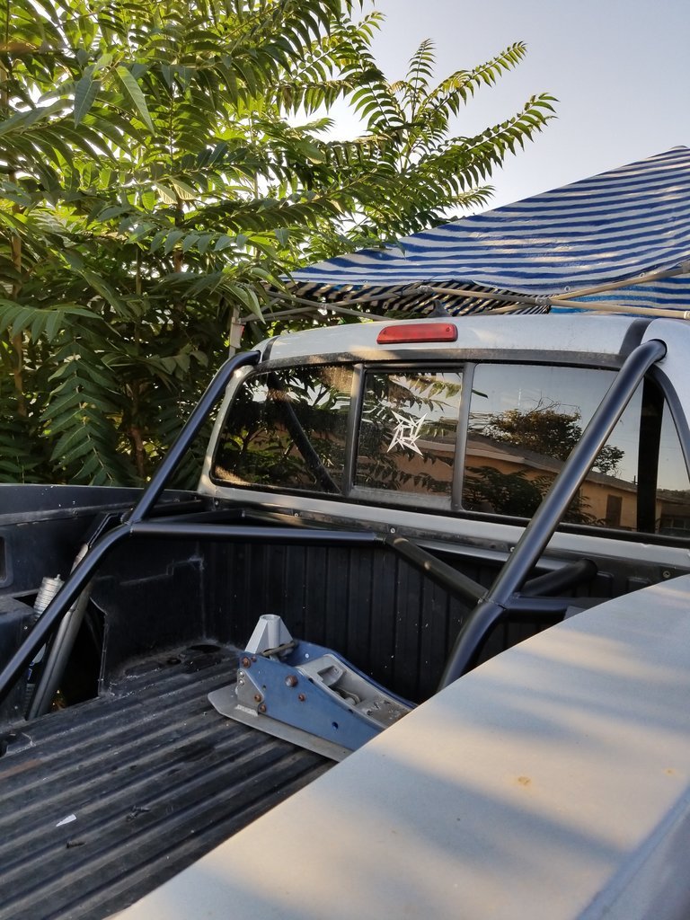

    Not welding the bedcage tubes to the cab aye?

    umm what ? lol. bed cage tubes to the cab cage ?

    Tubes going through the cab to the bedcage. Don't look welded to the cab. Optical illusion?

    yup. 6 points through the back of the cab into the cab cage.

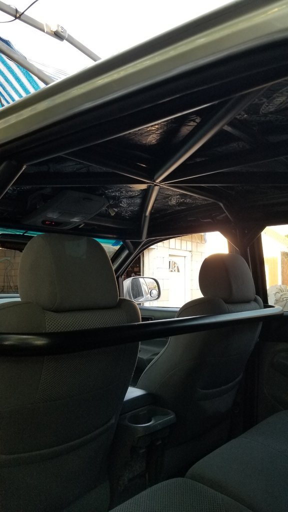

    The front section of roof with the console.... should of put two small X's in there instead of the two long diagonals... just sayin...and a minimal style b pillar web would be ideal....but that's being nitpicky looks pretty nice

    No problem with two long diagonals.
    dirt addiction likes this.

    just depends what you plan on doin with the truck I guess

    Doesn't look like they are welded. Wouldn't that need to be tigged?

    I miggerd mine but yes tig is ideal

    no door bars, no dash bars, it's missing all the race truck parts. it'll never work.
