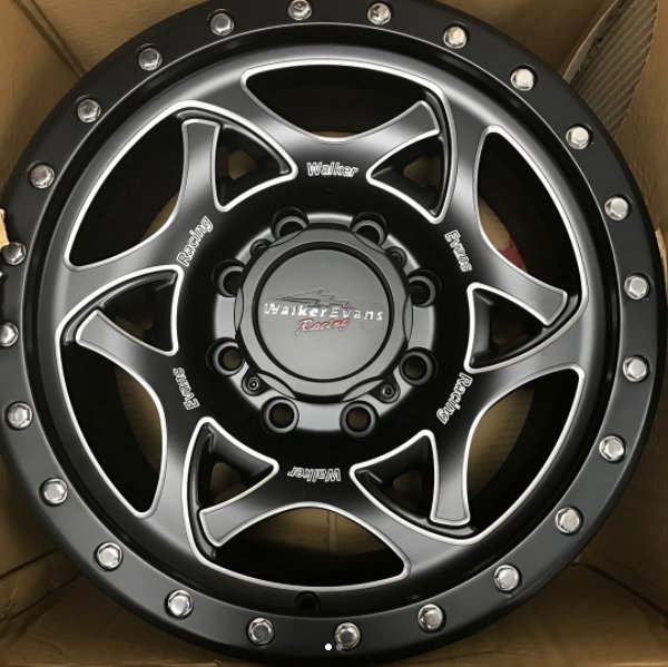

    I like Those new hubs you guys made for the tundra axles, will they fit our axle housings or are they only for the new gen axles?

    They are 2.5" Hubs for 2.5 snounts. The tundra has a fabricated axle with just weld in snouts we made. So not for the stock axles. Only make those and the ones for the Silverado.

    Oh, thats what I kinda figured out lol after really looking at the picture, still really awsome set up.
    Yea they are really pricy lol, they have wait time? So they make them on order?

    i think its just a new finish they are doing on the 501s that im thinking about doing, same thing that they do to their black forged. then my blue omf rock domes give it some extra color

    Def beautiful man, out of curiosity, are these at all street legal? I was under the impression that beadlocks arnt right?

    these are their street lock ones so they are fake,real beadlocks are legal but shops around here wont touch then cause they dont wanna be liable. im not about beadlocks after all the crawlers mounting 42" tires on them and it gets old haha i couldnt imagine doing 6 but i would opt out for some real walker beadlocks on my truck

    Damn I thought they were real for the price. I guess anodized aluminum is hard to come across for a beadlock.
