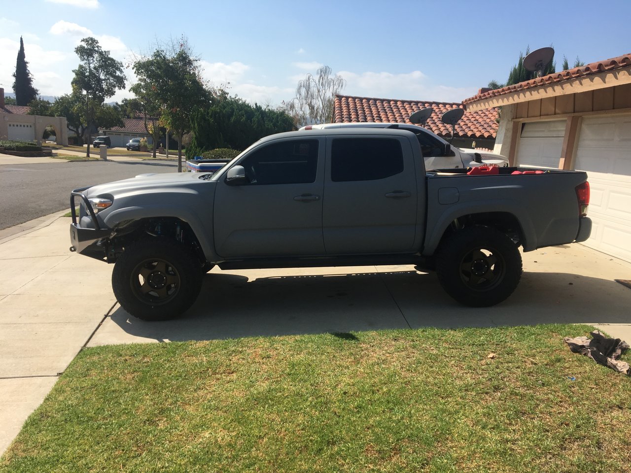

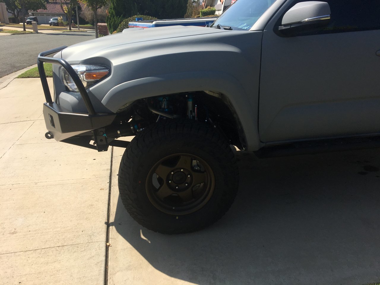

    smashed this, broke that, covered it up with tape and paint
    Left Cali yesterday, stopped for the night in grand junction tonight

    Love the color. Is that cement?

    Yes
    I was wondering the same thing, looks like a matte cement wrap maybe ?

    Correct
    Battleship grey
