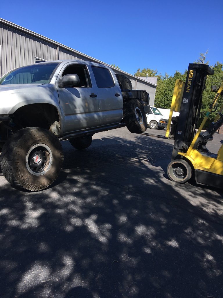

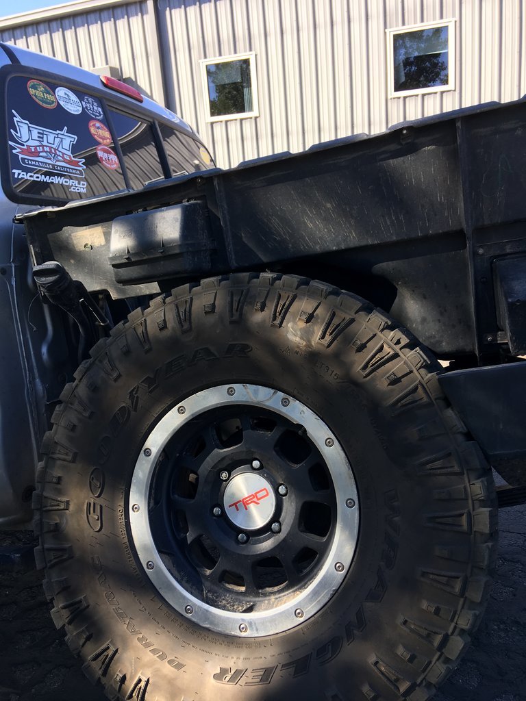

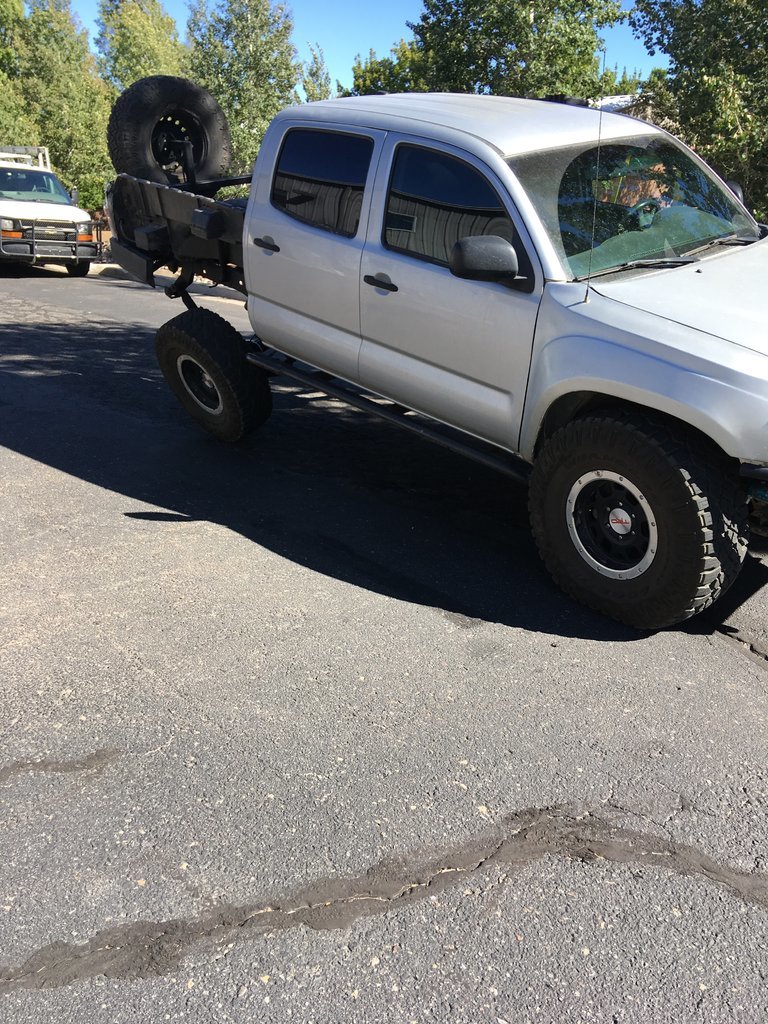

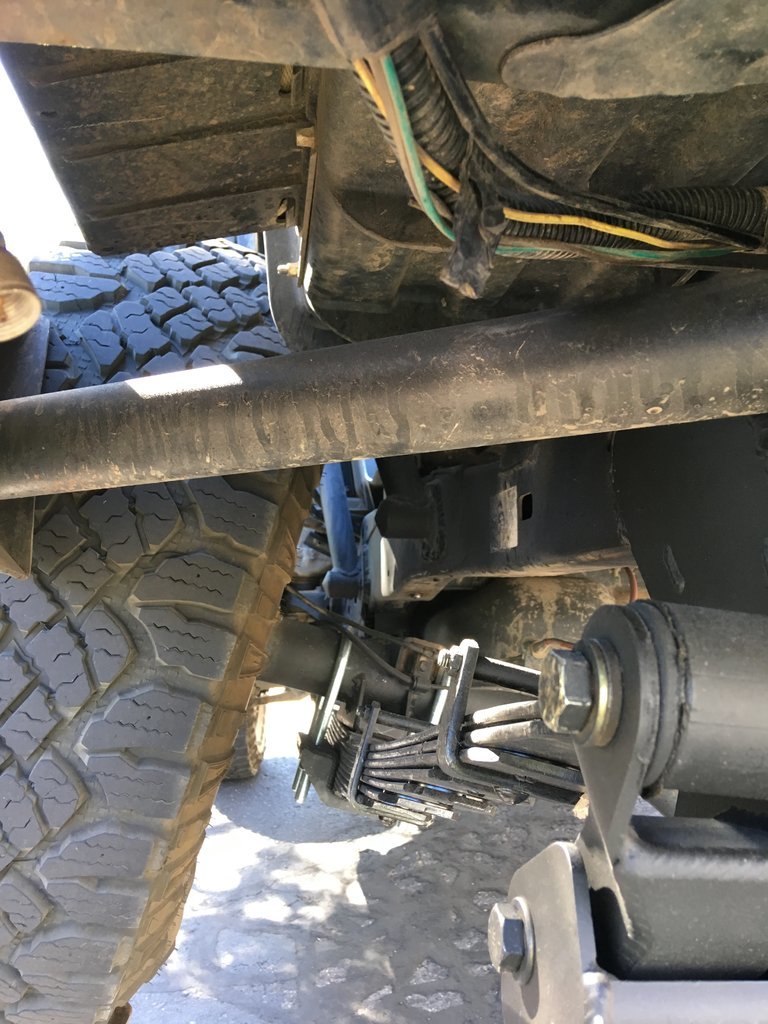

    Got to play with the fork lift at work today and see how flexy the sua can get. Ran into some clearance issues with my rear bumper and bed cage but that may not be an issue when shocks are in if I need to bump before this anyways. Still had about 2-3 inches before the axle would be touching the frame and about the same before the tire would be touching the bed.

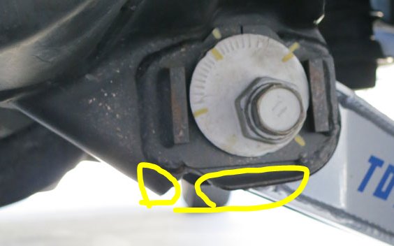

    Like reinforcements for their attachment points (not cam tab gussets, but reinforcements from the crossmember to the attachment points)? Or skids for the LCA's?

    One of mine took a good hit. folded up just under the caster/camber bolt (even bent inner bushing washer) and scraped some material away (about 1/4 inch).. (Rookie mistake not disabling ABS :(.. ) It's probably fine.
