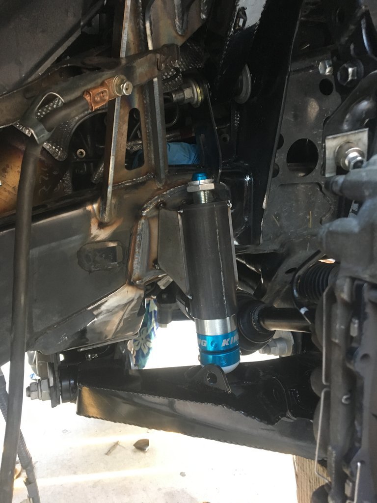

    Any chance of rewelding your stock mounts and using superbumps or is that more trouble than it's worth at this point?

    You're gonna run something...I would not run it with no bump stop

    You got a 2.5 bump?
    Should have gone 2.0

    2.0 king. Mine fit bro
    You can also slightly notch your frame to have it sit back a little more

    I'd just notch it. Once the can is welded on you'll have every bit of that metal filled back in anyways so there isn't much downside. And you'll never see it anyway

    This has been covered before. Bumping off the lower is cool if you like riding your bumps while your hittin dem speed bumps in the mall. It will affect your valving, just tuning your bypass with a bump zone would be best. Or be a man and bump off the upper

    Have any pics of those who have done this?
