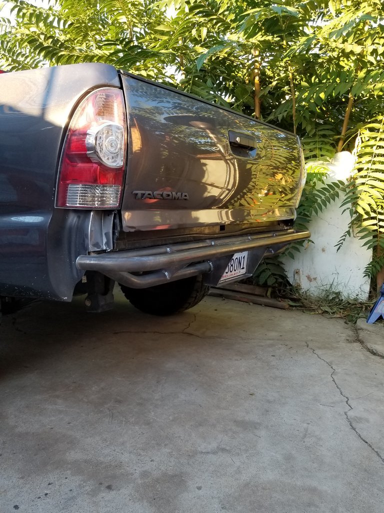

    Nice man, may want to reinforce that C channel first just in case if you havnt already done so.

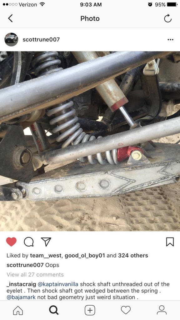

    I have bypasses and air bumps off the lower arm and still have the oh shit moment and slam the front end thru all that. I would never run without any bumpstop. It's just asking for all kinds of trouble. On my class 10 single seat buggy I got away with using the beam as a bump stop but the front end only weighed 200 lbs.
    Attached photo is why you should run limit straps. This was from a rocky road, the wheel is constantly dropping out over rocks and onto the limit strap. He didn't prep his shit and didn't have the limit straps on, pulled the shock apart in 25 miles.
    Bottom line--you must stop the wheel in both directions!

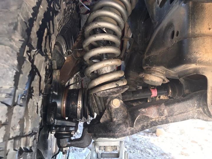

    My buddy had a stop added on the side of his TC lower arms. (sorry for the large images)
    [​IMG] [​IMG]
