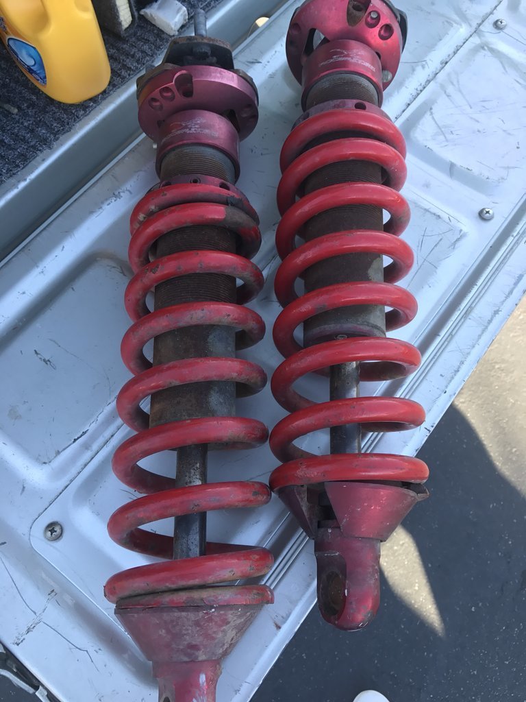

  14. Sep 27, 2017 at 11:26 AM
    txmxer
    txmxer Well-Known Member
    Jun 20, 2010
    #39228
    1,742
    California and Texas
    06 dc tacoma
    - Total Chaos 3.5 Long travel kit - Fox 2.5 coilovers w/ resis -Prerunner bumper -Fiberglass front fenders -Fiberwerx tt bedsides - Dmz Sua - fox 2.5x16 triple bypasses
    I don't want to start a thread and get random answers. What spring rate should I run with an arb bumper and a winch on a first gen? The coilovers in the garage have 650# on them now, should I bump up to 700? These are stock replacement saw's btw
    Getting some sketchy swaying from the bilsteins being way too soft for that kind of weight up front
  15. Sep 27, 2017 at 11:28 AM
    FlapJack935
    FlapJack935 i member
    Nov 25, 2013
    #117294
    3,196
    Jack
    Abq New Mexico
    Wannabe Trophy Truck
    Sick Gnar Trophy Truck Tacoma and King Ranch Raptor Killer
    i have 600# srings and mine rides cherry with a relentless bumper

    06 dc tacoma
    Interesting, I forget you have a first gen with a big ass bumper. Hopefully 650 is good then, I was thinking 700 would be unnecessary but what do I know.
    I need to rebuild the shit out of these coilovers including all the uniballs, gonna be fun.
    If I triple stack 50 inch leds on the roof will I have to go up in spring rate though?

  18. Sep 27, 2017 at 12:41 PM
    txmxer
    Jun 20, 2010
    #39228
    1,742
    06 dc tacoma
    haha were the former lt lurkers, this truck is staying mid travel too. 2nd gen is a little heavier though huh?
    I'll probably try the 650 that came on there then and try to save some cash. Can always swap Springs really quick if it's too soft. I've never had to deal wth a heavy ass bumper and winch like that, not even sure how often I'll use that winch.
    Have my work cut out for me, not bad for $100 though:
    Dalandser likes this.
  19. Sep 27, 2017 at 12:42 PM
    anthony250f
    anthony250f Well-Known Member
    Feb 18, 2012
    #73066
    16,777
    Anthony
    San Diego, CA
    2008 dcsb trd offroad 4wd
    I had 600s before and it was way too soft. I would try the 650s, but I'm super happy with 700's
    Knowing my lazy ass the 650's will be too soft and I'll order 700# springs that sit in the garage for at least 6 months lol. Thanks man.
