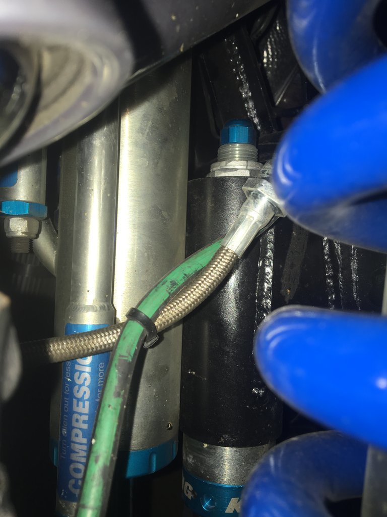

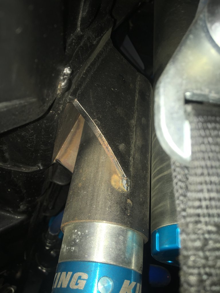

    I already told you I'm running 2.0 kings up front
    It's tight but they do fit
    There is maybe quarter inch of space between the body of the bypass and the can

    I don't remember all the details from the last few pages. But if 1/4" makes it work, shorten yours to 1.75" bumps... Still does the job and you have a bump stop.

    I'll crawl under the truck and take a pic in a few

    Didn't someone mention to just notch the frame where you cut the old ones off and recess your new bump can into there? Then just plate it all back together better than before. I think this would be your best option and you can create as much room as you need to clear the bumps

    Please keep in mind my set up is over drooped cause I was trying to clean out all the grease
