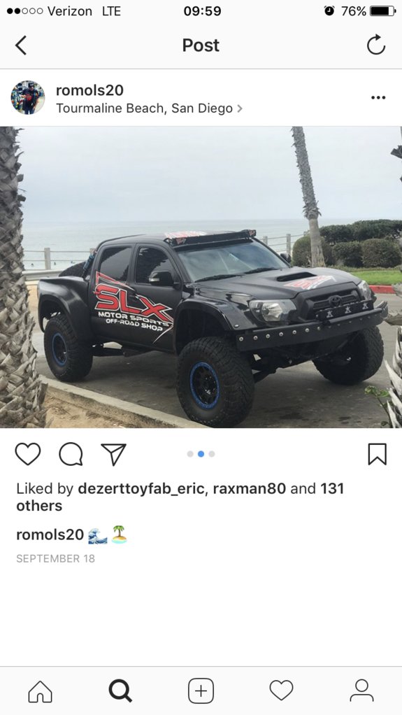

    What happened to that dude from mexico with the caged double cab 2nd gen tacoma? It was dark blue at first, I think he had a shop too. Just curious what happened to that truck

    This guy? Looks like he hasn't been on in a while https://www.tacomaworld.com/threads/my-never-end-build.227832/

    It's still around. SLX Motorsports
